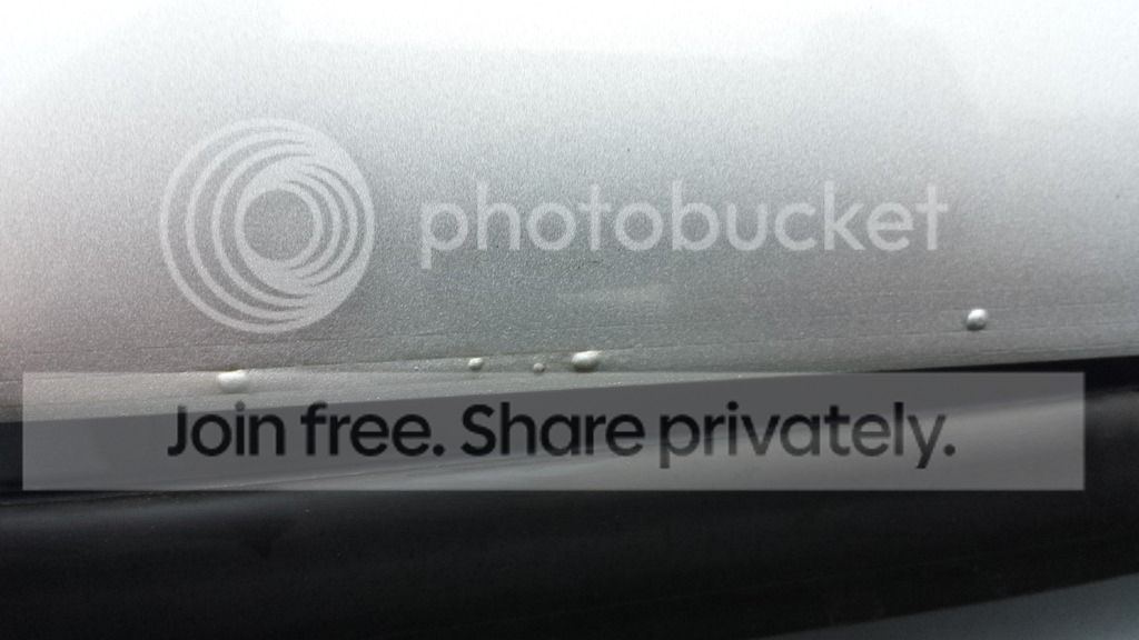

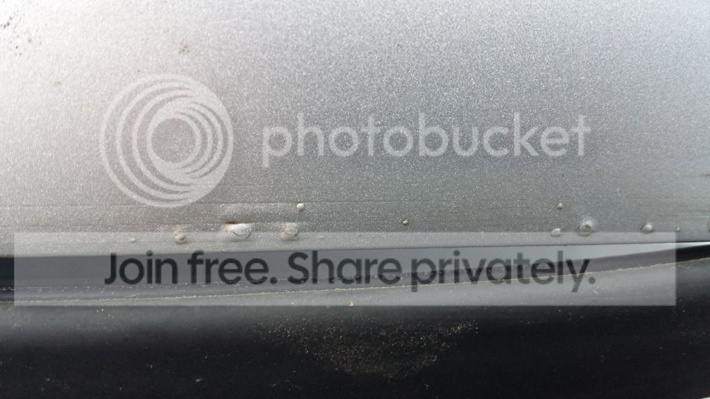

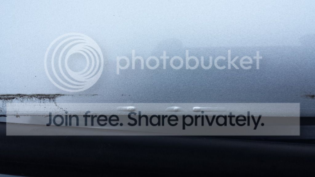

I am starting this thread so T6 owners and potential T6 owners are made aware that the T6 is subject to roof corrosion.
Here are 3 photos taken underneath the seal on the raising section of the roof on a May 2016 T6 California Beach taken today after our first trip away in her. .
Our much loved 2014 California SE was unsuccessfully repaired twice, the blistering quickly returned and it was booked in for a 3rd repair. We just could not bring ourselves to go through this all again and we made the difficult decision to part exchange it for the 2016 T6 Beach, thinking the problem had been cured. But obviously not!
So, our 2014 SE has it (three times), a loan 2015 SE had it and now our 2016 has it - the roof issue is still the same.
