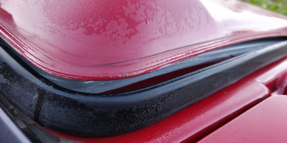

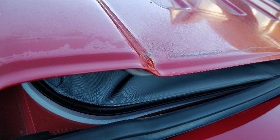

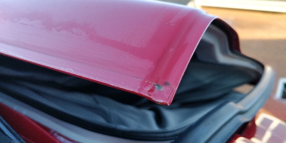

Here are a few pictures....
Sent from my ONEPLUS A5010 using Tapatalk
Hi Mint stuff,
the tape “missing“ on the front lip of the roof is normal, VW do not apply the clear tape to the front edge.
