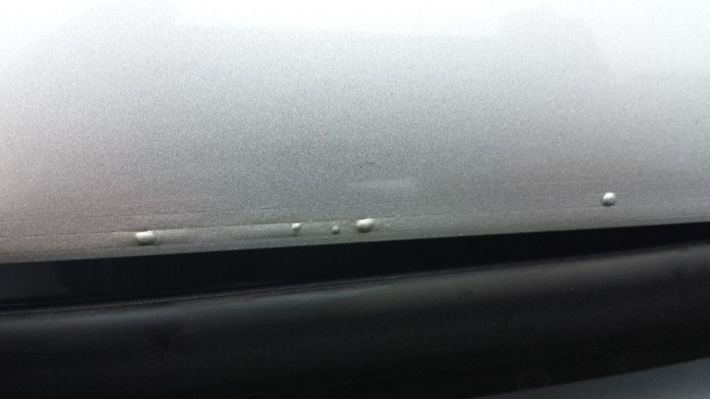

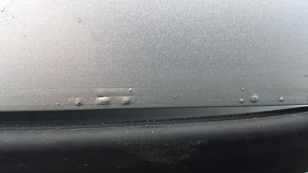

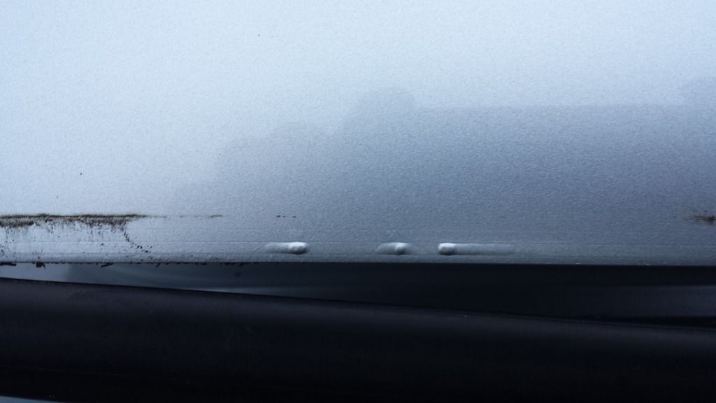

I am starting this thread so T6 owners and potential T6 owners are made aware that the T6 is subject to roof corrosion.
Here are 3 photos taken underneath the seal on the raising section of the roof on a May 2016 T6 California Beach taken today after our first trip away in her. .

Wow! This is terrible, that looks identical to the T5 corrosion so I can't see this being isolated. Guess you all need to check urgently

Looking at the pics closely there are 3 parallel lines in the paint. I wonder if the rubber seal was applied before the paint was properly dry and hardened which might have allowed moisture through to the metal underneath. It looks like the rust blisters are between the lines.

They all look like that.

Our old SE had corrosion on the under frame of the roof that is no where near any steel in the seal - so is it just badly applied paint all over the roof?

The edge of the elevating part of the roof , pull off the rubber and clean of the moist/dirt thats collecting in the rubber.( direct visible in the pitures of Snowy here above)
+ The front part of the roof , the part in front of the elevating section above the front seats , specialy the part where the plastic end caps of the Brandruprail are touching the paint.

They are apllying a tape arround the edge of the roof and then put the rubber back on so the alu roof and the metal in the rubber seal are not connected.

I think I'm right in thinking it's the middle one that's shown - and boy, that is bad corrosion for a 5 year old Cali, never mind a 5 month old one.
