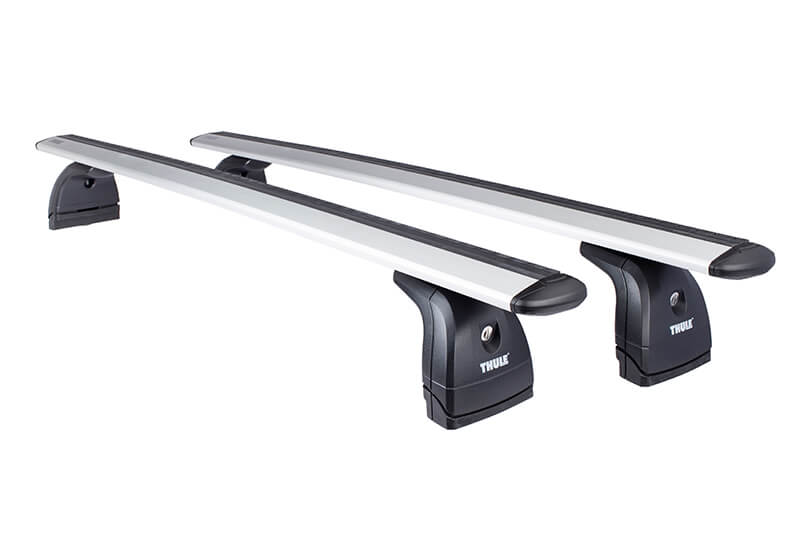

I bought my Thule ones from here:
I gave my vehicle [ >VW >T6 >California 2015+ ] and the website put together the three Thule parts:
- feet
- bracket
- bars
The VW roof bars are unbranded Thule, but as far as I know there is only one choice of Thule bar through VW. The above website gives a choice of four distinct Thule Bars (five in total) and two other makes of roof bar.
I paid £155 for black square roof bars. They look very smart on my yellow van.
However, with solar panels (6Kg), roof bars (5Kg) and a tandem carrier (10Kg) it is difficult to push up the roof, but pulling it down can be done with one finger!
