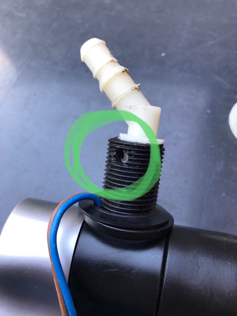

This shouldn’t really happen as that connector is the final part of the assembly when the tap is made. It’s a push fit then the threaded section into which it’s inserted is melted to hold it in place - see the picture below, I drilled out the bits that hold it in place on my old tap to see how it’s put together. You might be able to push this back into the tap but you’d need to insert a short grub screw (or two) to hold it in place. To be honest you’d probably be better replacing the entire tap so you can be sure it is watertight and doesn’t pop out again.
Thanks guys, here's a quick update.
The tap was indeed broken.
Went to a big camping shop (Falle Campingwelt villach) in southern Austria, as I was passing by anyway.
They had new taps on the shelf and the assistant knew right away what I needed, so my guess is this is a pretty common issue.
Took me 20 minutes to swap them out, including the wiring.
I think the price was about €30.
