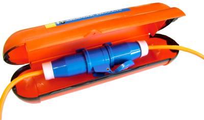

Something like this?
Here is a cover if you need / want one
edit: these boxes are not water proof, they merely cover the junction
