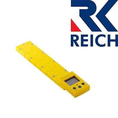

yep, in german forums this german product received a ton of criticism for its inaccuracy. swings of up to 80kg during repeated consecutive weightings ..For those that are nervous about how much weight they are carrying and can justify the cost Reich do weighing systems for vans & motorhomes. Not a lot for safety & peace of mind.
2 versions 1,000kgs max (yellow) and 1,500kgs max (orange). £185.51 & £203.45 from Ebay Seller.
Weighs one wheel at a time in a certain sequence. 10 minute job.
REICH WEIGHT CONTROL UPTO 1000KG | eBay
Find many great new & used options and get the best deals for REICH WEIGHT CONTROL UPTO 1000KG at the best online prices at eBay! Free delivery for many products!www.ebay.co.uk

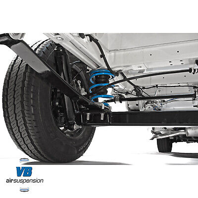

Is it worth installing T32 springs?This is a subject I've chosen to turn a blind eye to. This thread has rightly focused my attention to it.
We wild camp, so while travelling always try to keep the water tank as full as possible, plus carry an extra 10 litre container full of water. A lot of water! We also carry a spare gas cylinder, plus beer and wine.(survival kit). Always thought it looked like it needed T32 springs on the rear.
Our new van on order (no build date) is a T6.1 4Motion, so this is going exacerbate the problem due to it's less payload.
Think I'll have to pay more attention to this in the future.
No, because it won't change the rear axle weight.Is it worth installing T32 springs?
Think that Cali has the T32 rear springs from previous reading.Is it worth installing T32 springs?
Thanks.yep, in german forums this german product received a ton of criticism for its inaccuracy. swings of up to 80kg during repeated consecutive weightings ..
agree. Which is the reason I resurrected the thread. The only accurate way it is to use a public weightbridge which has separate front/rear axle scales.Thanks.
I did find the tolerance as + or - 3%. which would keep within the usual UK legal criteria of 8>10% over being regarded as dangerous use.
Alternative systems would be well over £500
