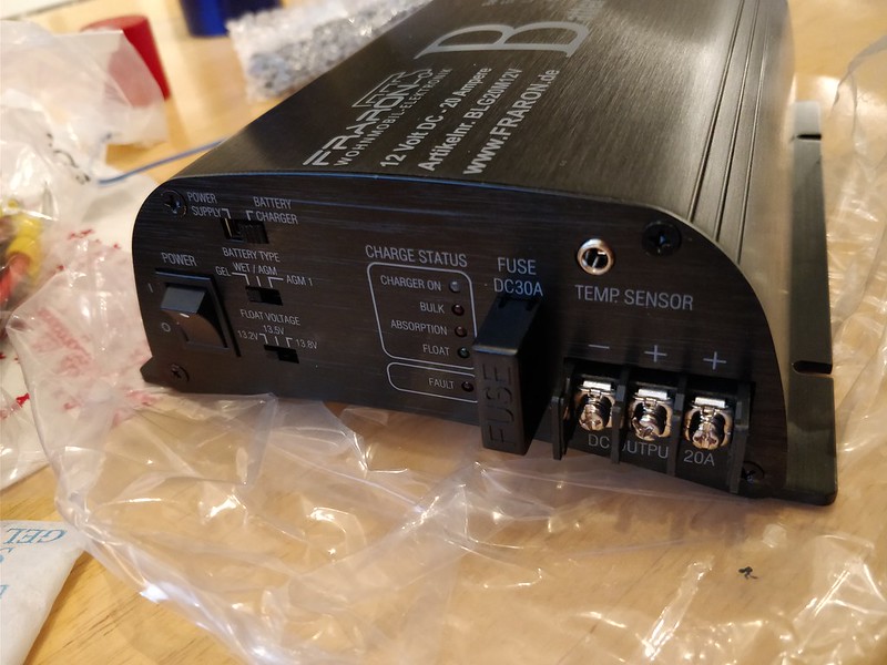

I was impressed by the look of the Fraron unit so I've bought one for mine before the OEM charger gives up the ghost. I was impressed with the dual output so I can do away with the extra charger Ive got fitted for the started battery. I was wondering if I should make a little access window on the side to view the status lights perhaps. Watch this space

Hi, Looks a impressive bit of kit. What’s the wiring going to be like switching it for the original unit?

It comes with two pre crimped pairs which will have to be connected to the existing battery plus the correct plug for the westy control panel. Just a new battery temperature sensor to the battery negative and that's it. Not fitted mine yet though as it only arrived as I was leaving for two weeks so I'll let you know when it fully fitted

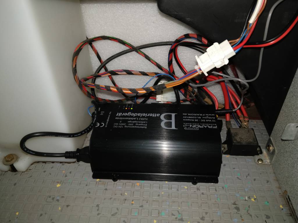

Excellent! Just had a look where the charger is sited under fridge and mine is totally missing.
Just the kettle plug and a bank plug sat in its place.
This replacement charger is definitely on my list to get in the New Year.

Finally got around to fitting my new charger. Works and fits a treat. Just got it wired to the leisure battery for now. Still to run a new feed to the starter battery to tie in with my excess solar charge unit
