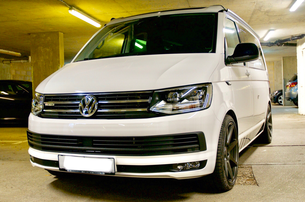

Any suggestions anyone? I’m sure the purists will be outraged, but I love the 9J front and 10.5j rear 20” wheels I’ve put on my Beach - handling and looks are great.
However - I’ve noticed on the face of my rear o/s rim that there are some fine scratches to the spokes caused NOT by my poor parking, but from the sliding door (electric) that just touches as it opens. I’ve removed the bottom trim off the door on the inside which you never see, and have put some soft tape on it, but does anyone know of a spacer kit or bracket to push the door out a touch more? I need max 1cm more clearance, and want to make sure the door still closes tightly.
Any ideas?

Yes you could be right - the door’s not broken so I don’t really want to mess with it, but I’m wondering if there’s a shim pack out there or similar
I can't see any way to move the door out easily as it would be spaced out in the closed position also.
I'd think that cracked rims would require replacing often enough not to worry about minor scratches (tongue in cheek).
You can´t really do anything to make the door extend further out when opened.
It´s the plastic panel on the inside of the door thats catching the wheel.
Maybe remove it and see if you can add some extra screws to press it in a
bit more or add some soft material to it so that it doesn´t scratch the wheel.

What offset are the wheels and is the van lowered on coil overs? The reason I ask is that when mine was lowered 70mm on Bilstein B14s it seems to have given a slight camber to the rear wheels so the inner door card just kisses the tyre when it’s fully open. I don’t think it did this initially, perhaps when it settled a bit but I’m wondering if raising mine by 10mm - 20mm all round might reduce that camber and solve the problem?
I think I read that the rear suspension isn’t adjustable for camber.
Another solution ‘may be’ to ask a wheel or machine shop to change the offset of your rear wheels by machining the inner face a few mm where it mounts to the hub (providing there’s enough inner arch clearance)- I’m not even close to being an expert’s cousin’s brother on this so you’d have to take advice from someone who is, however, the reason I bring it up is that some shops are supplied wheels ‘blank’ regarding offset and PCD - they then machine the wheels to suit your requirements.
Mine are only 10” wide (ET 45)- I have seen 10.5s on rears BUT these were on Multivans as opposed to Californias - perhaps they have a thinner/different inner door card? Stu
Could you remove the slider track from the body and shim it outboard slightly under its rear most fixing?
Then, as the door tracks rearwards it should also move outboard.
Leave the forward mount as is then it should close properly.

Agree, the rear bracket already runs very close to the removable side panel. Also If still under warranty you'd have to remove any shims before going to the dealer with any door issues.

Hi Chris, yes I think those will stick out an extra 10mm on the outer edge (10mm more clearance on the inside edge)
I really don’t think the sliding door will clear that. Sorry.

If you went with a 9” wide ET35 I imagine that would probably fit with no issues as it sticks out 3mm less and if it’s a concave look you’re after that should still be possible.
Mine are 10” ET 45 so if the width dropped to 9” (25.4mm narrower) but the offset stayed the same, each edge would move in (to the wheel centre) by 12.7mm. If you then increase offset to ET 35 that will push the wheel outwards of centre by another 10mm, almost compensating. I hope this makes sense.
In theory your outside rim would stick out 3mm LESS than this pic which is pretty insignificant looks wise and probably way more beneficial. (Less unsprung weight, more rim protection from kerbs etc).
