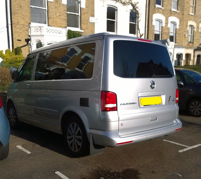

For mine (pictures above in earlier post) looks fine as follows.
The rear side left window which is partially obscured by the wardrobe, only the small part which is accessible above the fridge is covered in the film, the rest is untouched. From the outside it looks the same as the tinted window so there is no strange effect.

Hi Robin
Did your original windows have the factory tint? I think this might help to hide the mismatch. The van in the link below is the same spec as mine and you can see that the glass in front of the wardrobe looks clear compared to yours. Thinking I might need to get the window removed to do the job properly.

its a good point!! my van has what they call privacy windows (from factory), prior to the tint film being applied. the privacy windows were not that private, but your right they probably helped disguise the wardrobe window area. ps. your link doesn't work i.e. no photos appear.
