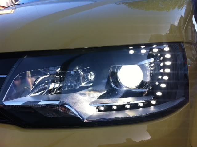

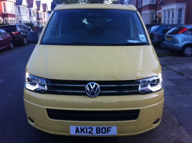

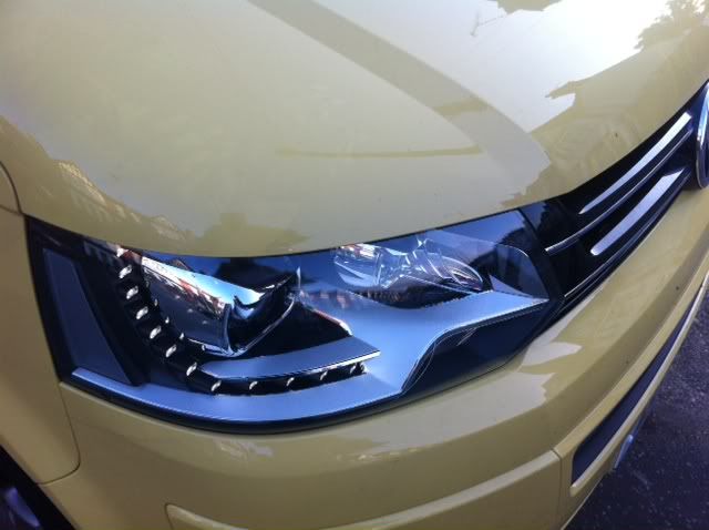

Much poorer and my budget for mods spent - but static cornering lights (fogs) and xenons fitted.
Look absolutely fantastic and the corner lights a very useful addition.
I had them done at Hazzydays - very good service - got a loan car for the day and all done by 5 in the afternoon.
I now have a pair of facelift headlights for sale...

Grrrrrrrr - I really need those. :boohoo
Look great mate, I'm glad it went ok. Did they do the levellers?
Did they have to change the BCM?

I don't think they did the levellers - also, as I said on the phone, no headlight wash and wash fluid level indicator which would come as part of the package if ordered from the factory (it can be done if you wish). I will check with the levellers.
Yes I believe they changed the BCM which is what they waited on - they did a video of the van and it is hopefully going on the website.
I can't justify the money i spent on them - they look gorgeous though and I thought whilst driving round Cornwall with the lights, they are okay, I just felt a bit of extra safety would not go amiss.
I spoke to Gareth at Hazzydayz and they are going to start offering the colour DIS - but I shan't be going there lol
I've also added the VW cool box which is bigger than expected.

They look great mate but hang onto your old set of lights as you will need them come MOT time
Levellers and washers are a legal requirement with Xenon headlights and they are now checked as part of the MOT due to the amount of aftermarket xenon's available
Just put the old one's back on and you'll be ok :thumb
