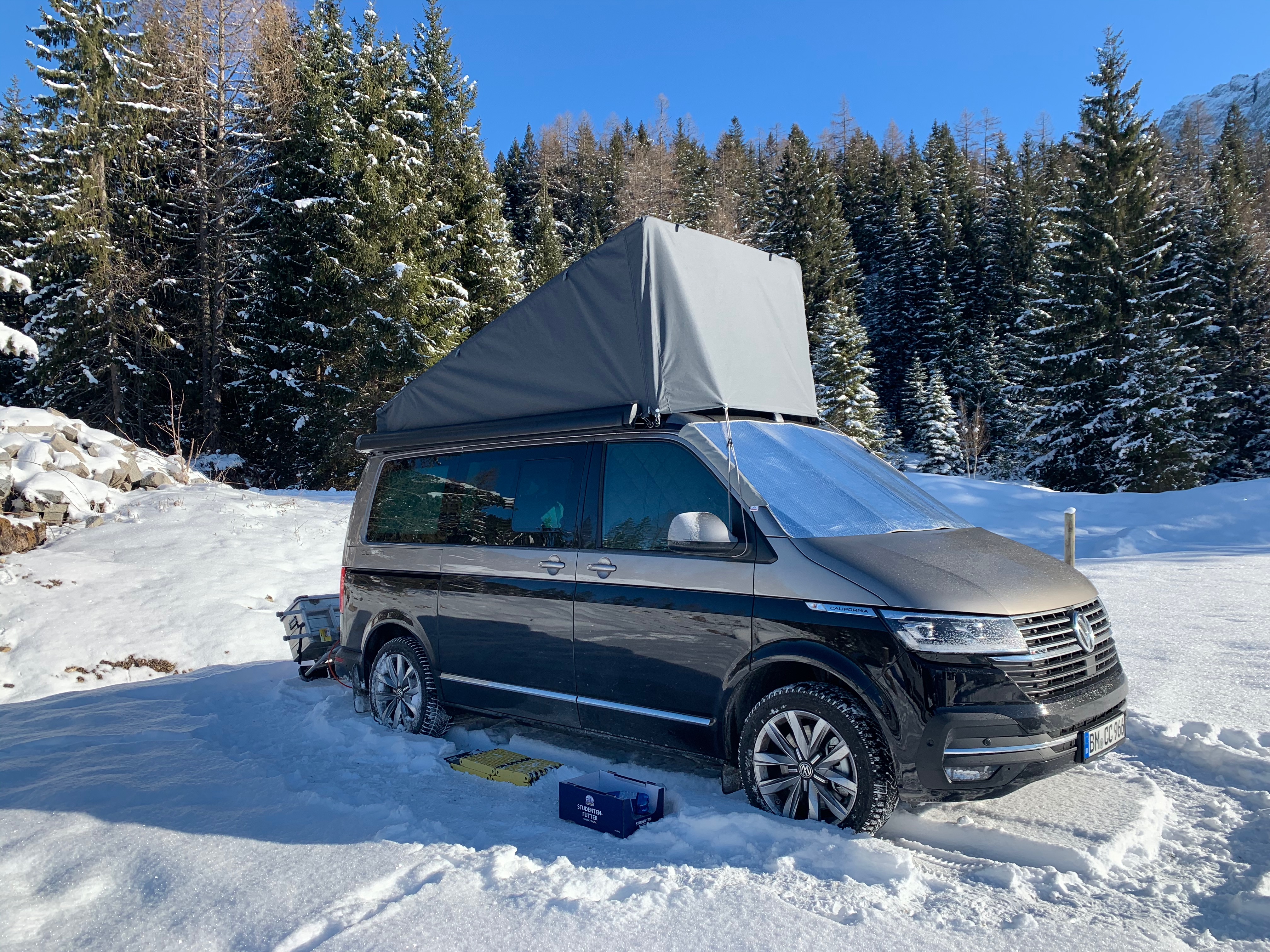

So Caliwrap or topper, any thoughts?
My Calicap II is being assembled and should arrive in a couple of weeks
