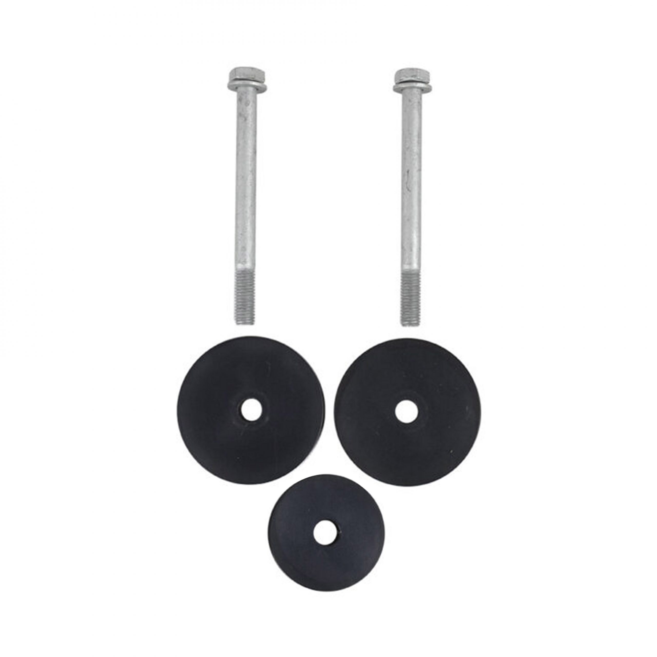

Here you go then, set of these & keep your original springs, these are 25mm but other sizes available.
Nothing to go wrong with them, keep standard Transporter springs with worldwide availability.
Thanks - I lifted my Ducato using 5cm spacers - easy, inexpensive, and did the job.
What's the downside with using these?
Do I need to add these diff spacers?

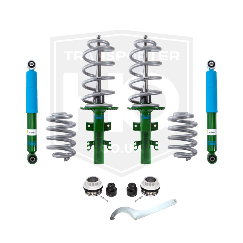

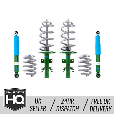

I have eibach 35mm adjustable lift kit with t30 komfort struts and dampers and the diff spacers the ride is better than standard less body roll and very similar stiffness as standard best money I have spent it has changed the van into a capable soft offroad camper
Thanks. Similar to this?
this is the one its adjustable on the back,transporter hq fitted mine really good service.

If using the spacers, are the rear diff spacers also necessary?
