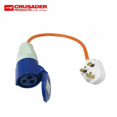

I have a question, which hook-up plug we should use in the future, UK or Europe?
This is the original cable with my new Cali:
It’s too short, so I bought another one,
In the UK, I think I should buy a different plug, so I bought the third one,
but I noticed at many places, there are some charge pile like this,
and lots of different charge plugs on sale in Ebay, 7 pin and 13 pin ?
Woo, how many hook-up we should to buy in the future in UK and Europe?
Thanks for your sharing
Second one with the orange cable. Take the first one with you in Europe in case you come across a camp site with an older hook up. It will connect to the second lead which will plug into your van. The fourth photo is an electric vehicle charging point so not relevant.

As above, plus this lead so that you can adapt the Orange lead so that you can plug into the Mains on your drive, which you should do every month for about 24 hrs to maintain the Leisure Batteries .
The first one is only any use if you have a 2 pin extension lead
or if you can park 0.5m away from the plug.
I would stick at 2 and 3.
Keep and use your yellow lead, pic 3, for home charging. Take your orange lead, pic 2, for camping. No need for anything else...
Use your yellow lead, pic 3, for home charging and orange lead, pic 2, for camping. No need for anything else...
Ah, but sometimes when visiting my daughter on her smallholding we plug into the mains via a domestic socket and I would prefer carrying the adapter rather than a whole lead. Much easier to carry.

Thank you so much!
I still want to know, can we use the charge piles with a conversion plug just like this?
In almost 8y California camping i never came accros that charge pile that you show above ? Are they not for charging electrical verhicles ? Having a flat spot and not round plug
Every campsite we visited in over 12 countries all had the blue three-pin plug .
Thank you so much!
This is for a trailer on your towbar.
You have 2 7-pins and 1 13 pin connection there.
You can't use it for any means of charging, unless you count the constant 12V and switched 12V for your caravan, which isn't present in a 7-pins connector.
Thank you so much!
Thank you so much!
No. They are for Electric Vehicles.
You could try, but don’t tell your Insurance Company they might not accept your claim that the California just burst into flames.
We've stayed at several campsites where the 2 pin adaptor has been required. I carry so many cables and adaptors I've lost track, and in Italy you're likely to need at least three different types of adaptor: Italian 10 amp three pin, Italian 16 amp three pin, Euro two pin.
@Amarillo , i also carry my two to three pin short lead . But was just pointing out that the standard on most sites is the blue three pin .
And if there should be a problem , most campsites wil have the correct cable/adaptor.in theire shed to borrow , or borrow one from a fellow camper .
I even made myself a UK-plug to three pin , that we take allong only when visiting the UK .
