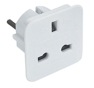

Some of the adapters actually swap over the live neutral lines, found that when plugging into holiday home in France sockets.
This commomly available type
Some of the adapters actually swap over the live neutral lines, found that when plugginto holiday home in France.
The polarity question has been covered extensively elsewhere on the forum. I believe the answer is don't worry about it, you won't do any damage (unless perhaps you try and plug in your granny's 40 year old single earthed hair dryer and even then you'll probably be fine).
I know but just advising of this unexpected 'feature'.
Had me going in circles for a while with this on my polarity tester showing incorrectly wired wall socket.
Can't even pretend to understand polarity issues !
