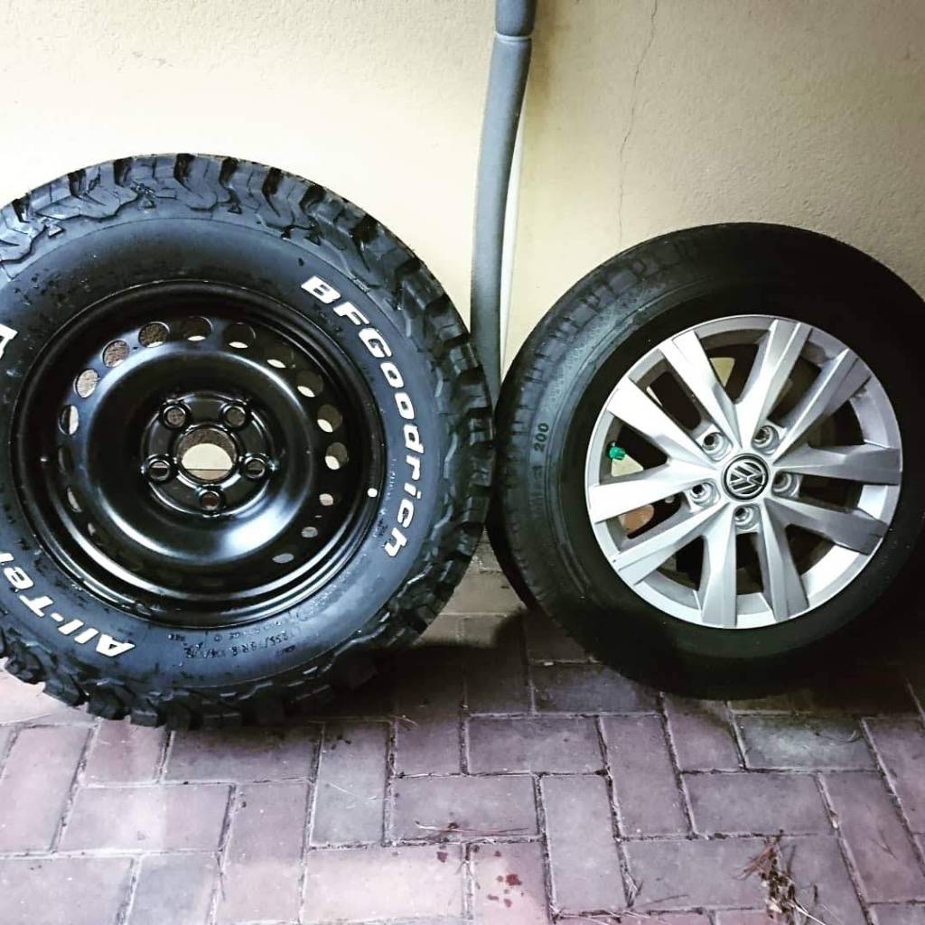

Hi Alistair Haven’t done anything with front yet . Think I’m going to fit BfGoodrich Ko2 first but may upgrade front suspension to Bilstein but think I read T32 front doesn’t fit a California .
Hi,
Yes, I think you're correct about the front, I think it's different somewhere

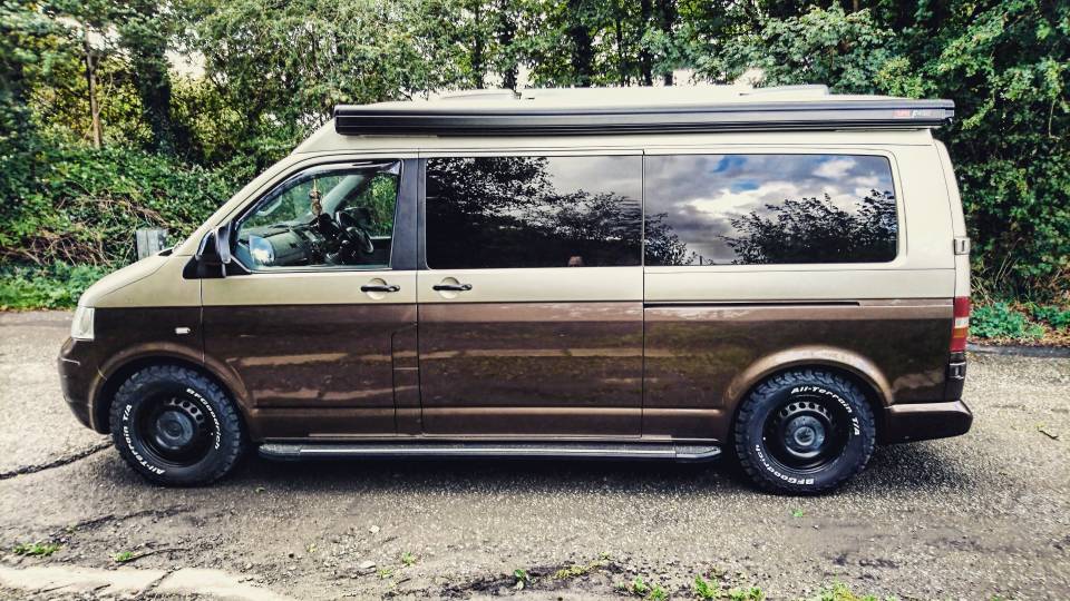

I already have the BF Goodrich All Terrain K02 on my van, on stock steelies. 235/70/16
Alistair
