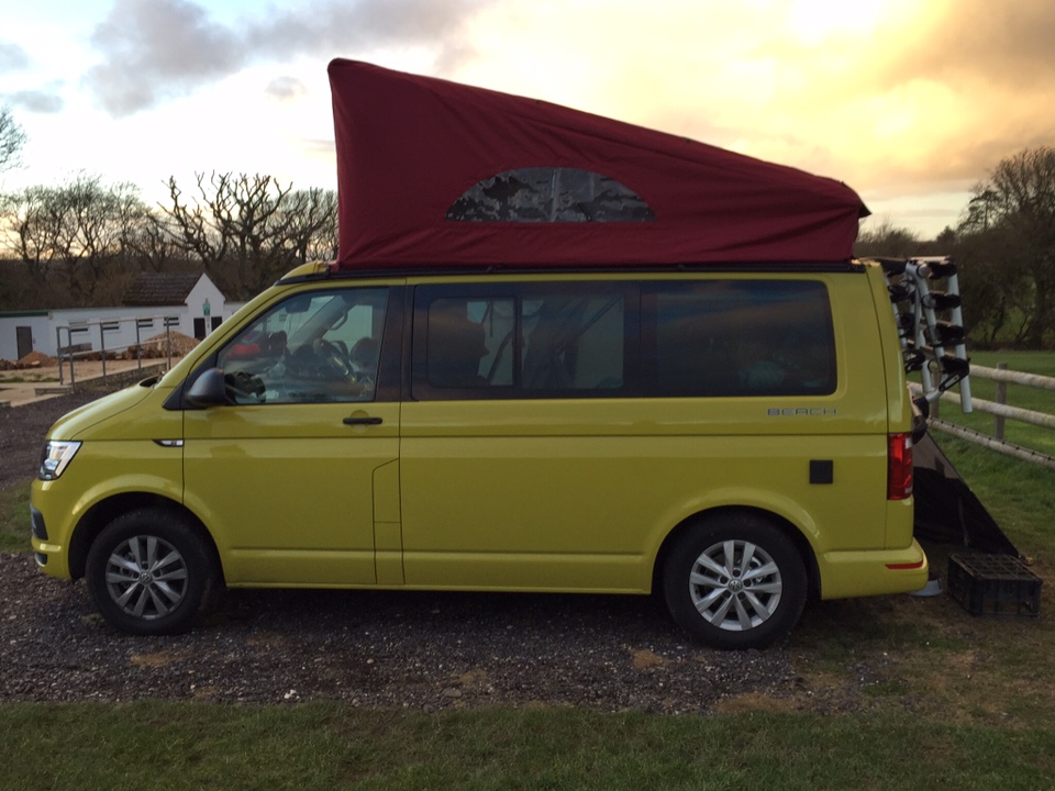

HI Blondebier,
It is fairly easy.It was a very warm day, I peeled the rubber seals out of the way and made sure the pillars were absolutely free of every spec of anything.
2 tricky parts for me IIRC...
1) Despite the heat of the day the edges at the curves took a small leap of faith whilst telling myself it wouldn't break the bank if it didn't go well. But you have to commit.
2) Positioning, Mine have ended up slightly high.It was always a juggle up or down and I got it wrong.I didn't think of tape which may have helped as I could have stood back from it and looked brfore it was too late. That really annoyed me for about a month and I was convinced set number 2 would be ordered. But here we are and I don't even look that hard. The black pillar effect was achieved and the appearance of the Cali is subtlety enhanced IMO.
But now you've mentioned it I might start scrutinising again :headbang
