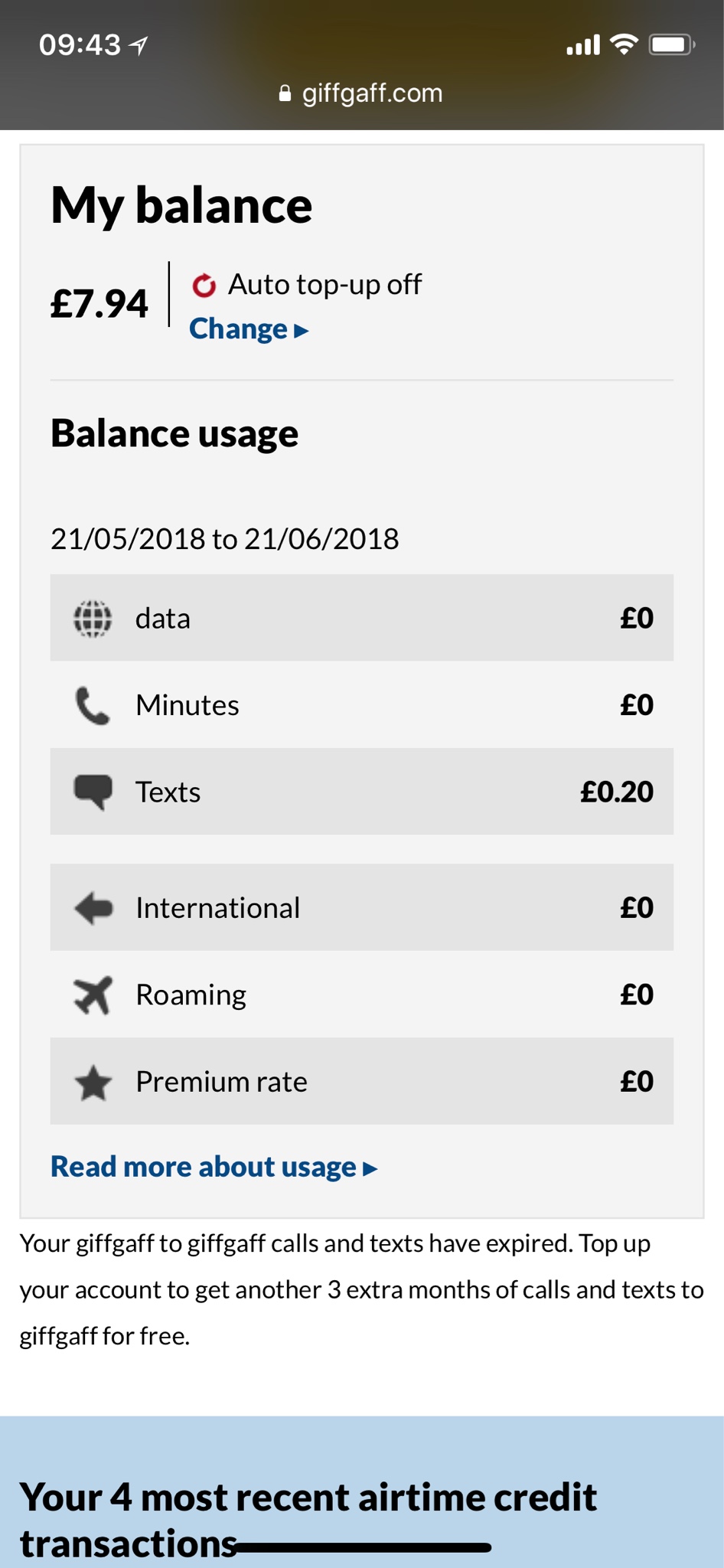

I noticed on my GiffGaff statement that my tracker is doing small 1mb data transfers twice a day.
Are yours doing this? I was wondering if I have inadvertently enabled something with a setting. Normally I ring it and it texts me back and these show on the account but I cant explain the data usage??
Any ideas?
Not sure if this helps but I’ve only ever be charged 5p when I make a call to it.
These are the last 4.
No 1p ones

Not noticed it on mine except for the texts. As mine runs on batteries when it was running flat it would Text my phone & Helen's a couple of times before I could get to it & turn it off to recharge.
You haven't got Geofencing set or anything have you? If you call them he can set it back to factory settings remotely.

Mine isn't doing data transfers that I know of, there is a command to enable and disable sms/data andI have disabled data...
The commands are:
sms[password] to change to SMS only mode
gprs[password] to switch to data mode.
e.g. sms123456 gprs123456
Weirdly mine does still send the texts when in data mode (apparently it shouldn't) but not the other way around. I've been on the same £10 tesco triple credit for about 4 months now. ;)
