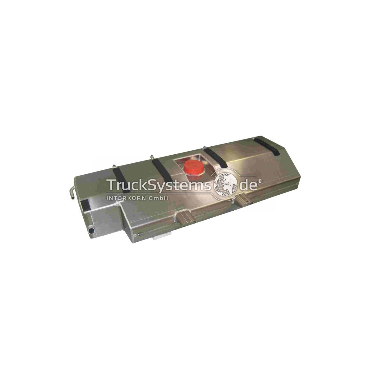

Cheapest 80l one on eBay is 145€, tank only no pump.
For the T5 there is one 150l but costs 2075€ + 650 fitting with TÜV.
a guy on the german cali site got one fitted.
Wow... 150L... That's nice... Simply forget about the tanking up...
