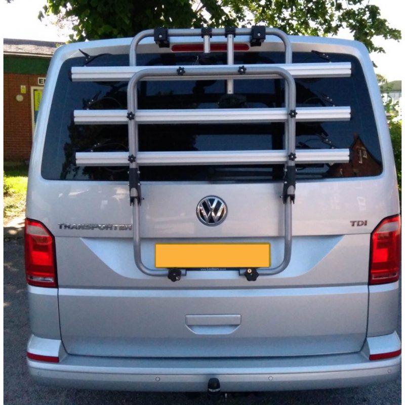

Fiamma Pro fitted today. If I am honest is was a bit of a faff to fit but kept at it and with a bit of advice from @Loz (Thanks again!) all is good. I now have a two bike rack that will be a lot kinder to my back! No more leaning over the four rack version from VW.

The rack comes with instructions, four clear vinyl self adhesive strips as paint protectors and two rubber pads for the two top mountings.
The two rubber pads do not fit the top plastic mouldings. Recommend replace with 1mm sheet rubber (here is a good source: https://www.amazon.co.uk/dp/B00MTW4VRA/?tag=eliteelect-21 ) and cut to size, or carefully cut off the silly lips on either side of the pads and just use the now flat pads as per the instructions. Be careful not to damage your tailgate hinge paint during installation. The top brackets are tricky to fit - some lifting / thrutching etc will be needed. I suggest you wrap the lower brackets in a soft cloth so that they don't damage your tailgate during top bracket installation. A spare pair of hands was always on hand for me - I suggest you have this facility too!
OK to the bottom brackets. The clear vinyl strips will only provide limited protection for your tailgate paint so go easy if you go this way. If you go the 1mm rubber sheet route for the upper brackets then you will have some sheet left over - use this to wrap your lower brackets to provide a cushion before installing. You will need to be careful to align your lower brackets so they do not foul the light cluster when your tail gate closes. If you have a soft close tailgate be careful not to let this close before you are ready. Take your time. Don't start this job if you are in a hurry. You will regret it!

Brilliant, thank you so much! I’ve got some extra thick helicopter tape (rhino hide) I was going to cut to size to protect the paintwork under the 4 mounting points. Will see if that works as a substitute for the rubber otherwise will get some of the stuff you’ve suggested.
Thanks again, much appreciated.
Well, it’s on. A bit fiddly compared to my previous VW rack. I found the top mounts OK but did put helicopter tape on the tailgate underneath the whole top brackets anyway just in case anything could mark the paintwork.
On the bottom brackets, I used helicopter tape and some rubber strips I had in the garage to protect the paint from the chunky metal retainers. They are very close to the light clusters, probably not helped by the added protection.
I think the VW rack is slightly better quality overall, however, this is a great option for 2 bikes and if you want to leave on most of the time. If you remove the 2 bike brackets (which seem very nickable) when not carrying, you not only stop them rusting but have an almost completely clear view out of the rear window. I could hardly see a thing out of the back with the VW rack on!
