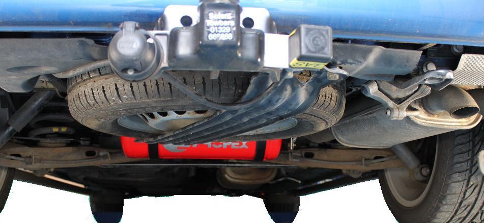

That’s interesting. I wonder how much it costs.
I think that I was quoted £600 as an add on extra to a new T6. (Not California, but near equivalent). I feel that this is only worthwhile if it is specified from new and can also free up space, whereas a Gaslow cylinder type system can be easily retro installed at less cost in most campers, but not, it seems, in Californias. I am sure that there are enterprising converters to be found who could figure a way.
