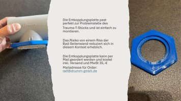

Hi. Has anyone else had an issue with a crack in the bathroom wall? The crack is on the wall where the heating vent is located - Suddenly appeared, I am assuming it must have something to do with the heat from the Truma heater??B9B91BC9-93A0-40AA-B2BA-9AC287B2C76F.jpeg

Looks to me as if the heat defuser is either slightly misshapen or the hole is a tad to small then the hot air enlarges the defuser causing it to expand and crack the plastic walling and obviously a defect and should be a warranty issue.

Thanks Jester. I would agree with your thoughts, definitely a heat issue. We have informed VW; however, are about to go on a long trip in the van; therefore, the issue will not be resolved until we return in mid May. I will update once I return.
