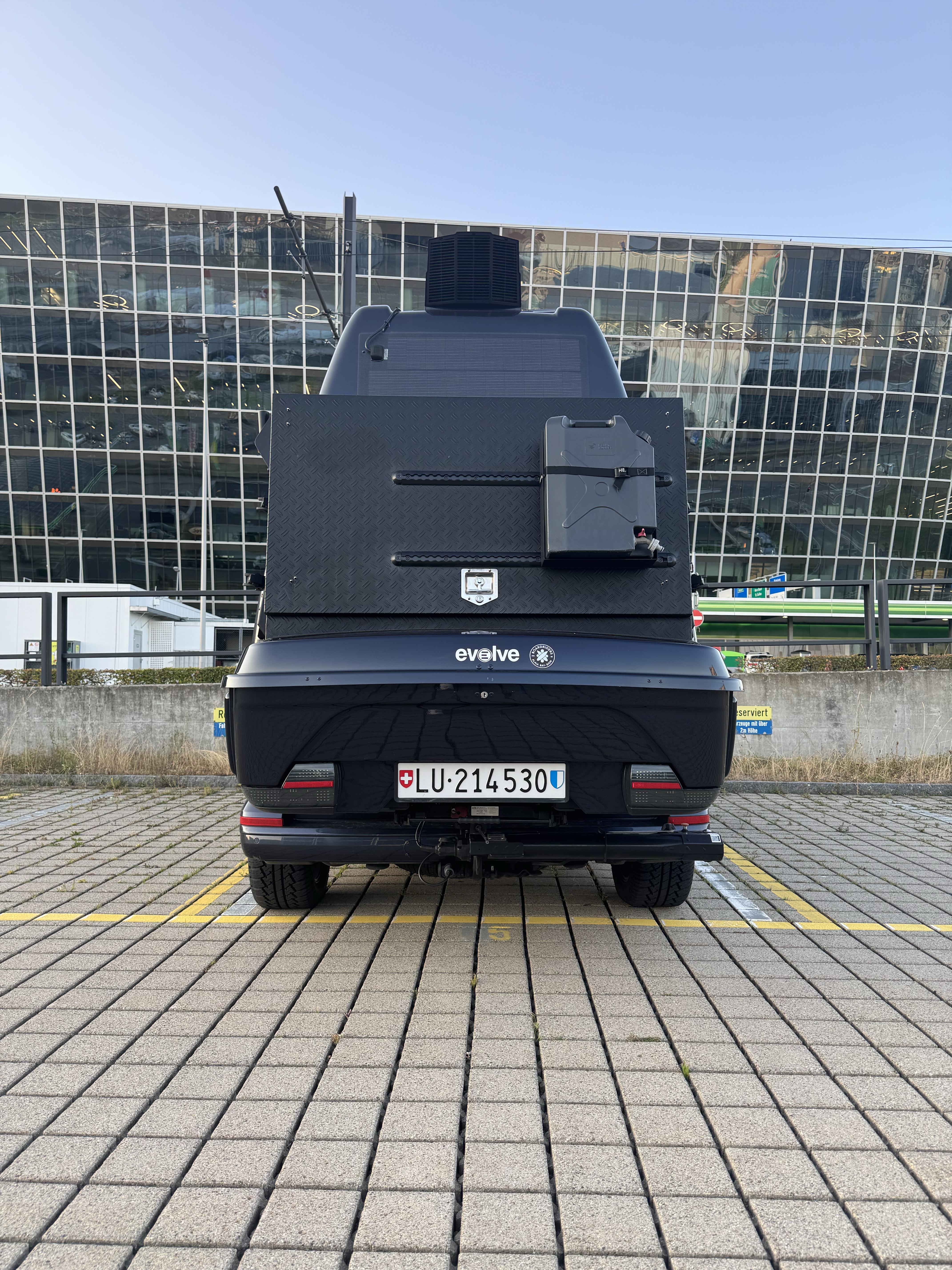

Yeah, that’s why I bought a swing away arm. This way you don’t need to tilt down, but you swing the box or bike rack away to the side.

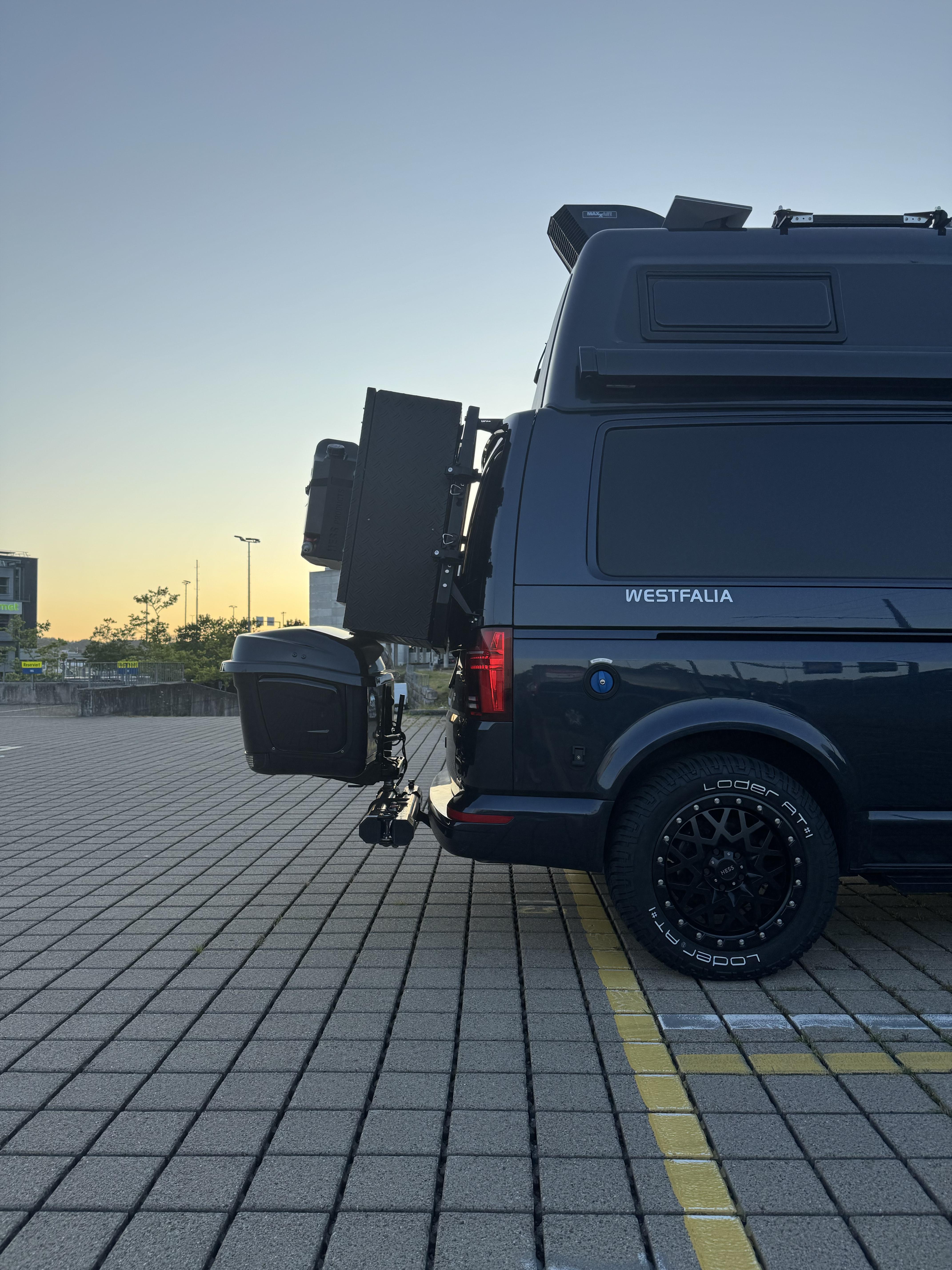

This one I have:
In fact I already are using an even cheaper option. A Thule 929 with alu toolbox:
However, filled with wine, olive oil etc from our trip to Italy/France it’s really heavy to tilt down and up for access to the fridge in the boot.
The MFT backbox comes with an optional long removable pole , that slots into the rack between the back of the box / back of van, that acts as a lever to overcome the heavy tilt….it should come as standard with the rack really!
Yeah, I have that too but found the swing away to be a much better solution. Especially when the box is full loaded or if I have 2*30kg e-bikes on the rack.
The other reasons were for clearance due to the box on the rear hatch for handlebars of bikes and more importantly ground clearance and angle of approach when off-roading. Best seen in the photos below. Perfect fit!
