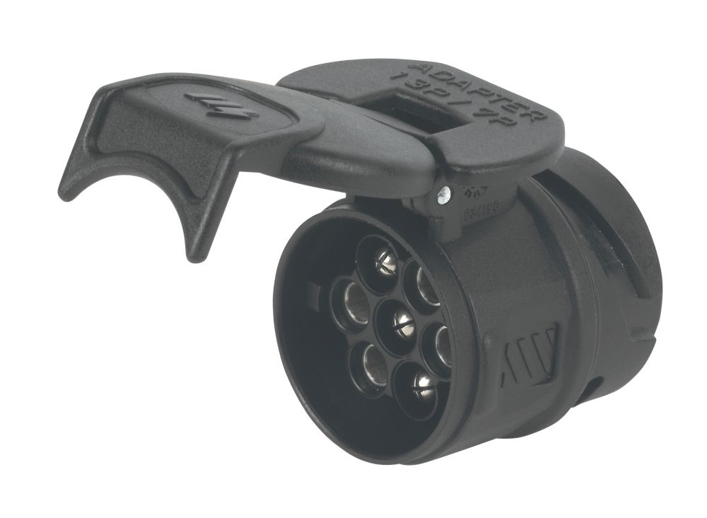

Should work: the only thing that won’t is the live and ignition live terminals for a trailer fridge. You may need one of these:
