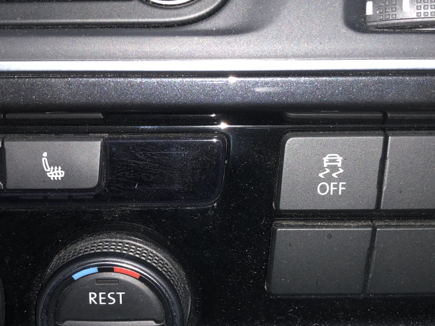

I think the T6 4Motion has the switch.
You could try this. - see last post.
http://forums.ross-tech.com/showthread.php?7111-VW-T6-4motion-esc-disable/page2
Yep T6 4Motion does

Yes, ALL T6 with 4wd have the switch, NO T6 without 4wd have the switch.
