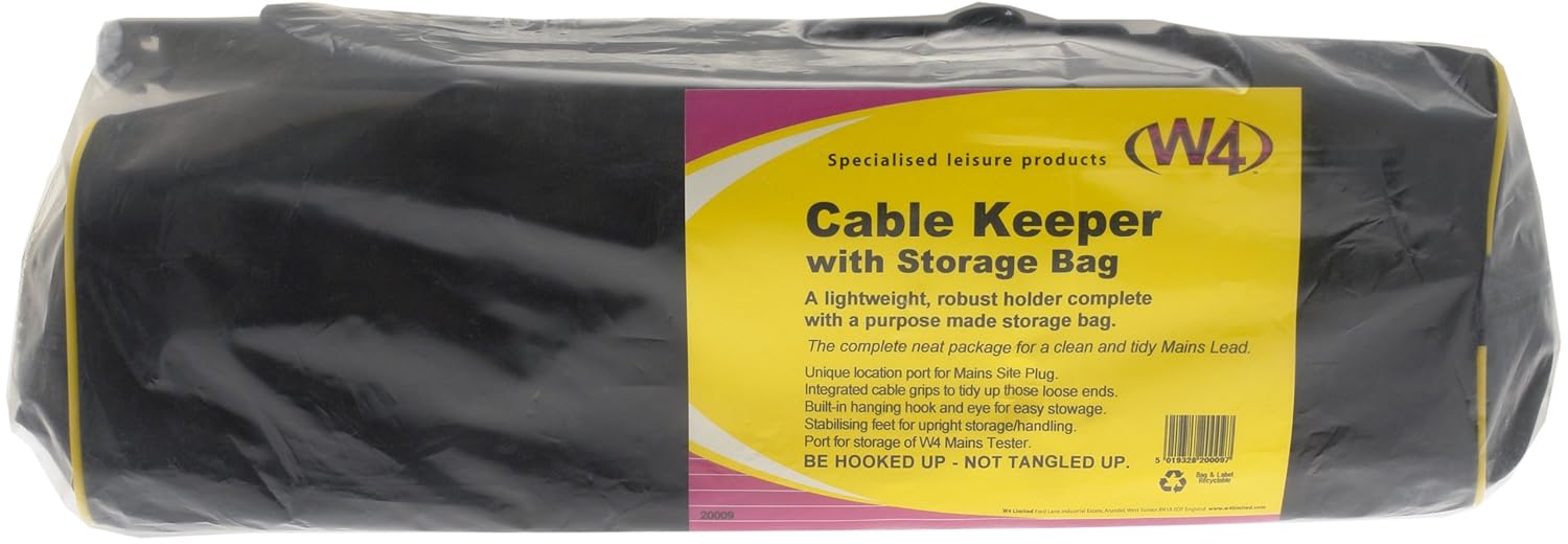

Equally important is the size of the cable when stored. For many years we've been using the W4 20009 Mains Cable Keeper with Bag, which holds up to 25m in a very small package. (I did cut it to 20m to make the cable easier to fit.) Very happy with it!
