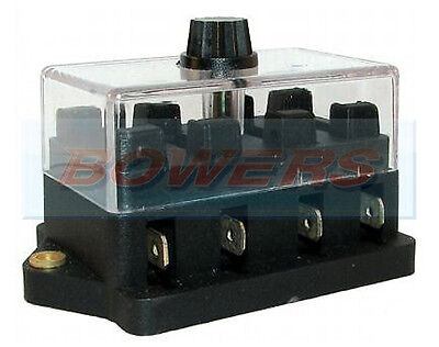

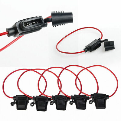

For the fuse, you could use an inline one like this:
or a fuse box something like this:
Incidentally, when i did my emergency install of this i didn't have the fuse available and did install without for a period of time (I think the unit even has its own onboard fuse?).
