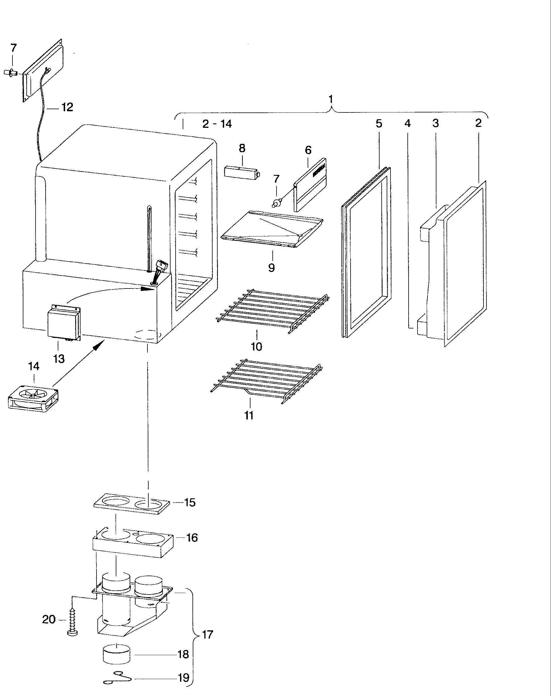

refrigerator - Campmob. (Typ2/Transp./LT)(CAMP) [EUROPA 1994 year]
part codetitlei
refrigerator
1-4no longer available
5701 070 504 Cdoor seal
6701 070 507 Brefrigerator lid
7701 070 507 spreader rivet
8-11no longer available
12701 070 505 temperature sensor
13701 070 503 control unit for cooler/ refrigerator
14701 070 504 fan
15no longer available
16701 070 128 Bsealing plate
17no longer available
18701 070 510 air filter
19no longer available
20N 0139755oval head panel screw
