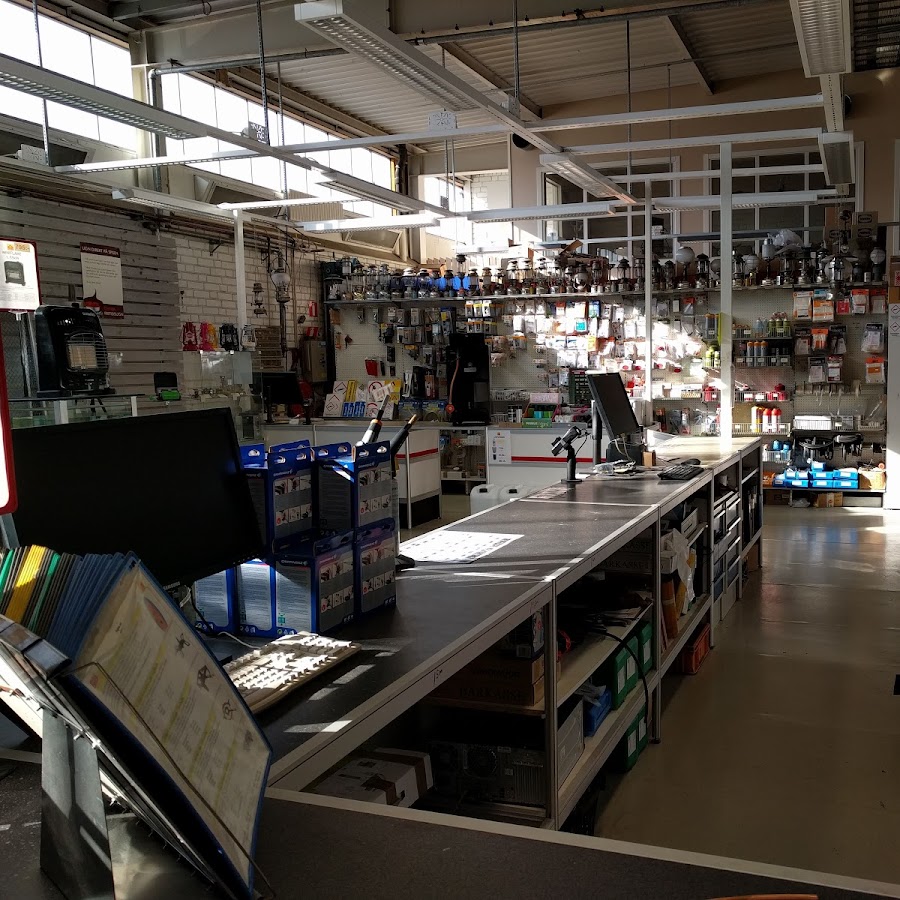

I bought the ALUmini and it fits nicely in the van without any adjustments. But beware that it can't normally be filled in Sweden as it doesn't have the normal Swedish attachment, rather the European one. I found one place in Stockholm where they fill them. But beware that they complain that the bottle doesn't have the, in Sweden, mandatory safety valve. Apparently this is no problem when it is attached to the van, rather when it's stored as it will explode in case of fire without that valve. But a bit reluctant they filled it: Fogas at Upplands Väsby.
