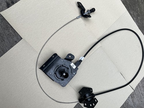

The spare is 16 inch with a larger profile tyre ,think it's 65.
The Man spare mechanism will do but you need the earth wire which has the securing bolt for the wheel attached to it..
Ps there are two types of drive sockets for the winch .
They are five sided ,the newer ones have a larger drive.
Vw do an adapter for the smaller one £17

It’s not an earth wire, it’s a security cable that stops the spare bouncing down the road if the winch fails. It’s bolted to the wheel at one end and the van at the other.
Makes more sense now ,don't know how I came to think it was a bonding cable.
To be fair it does look exactly like a battery earth lead.
