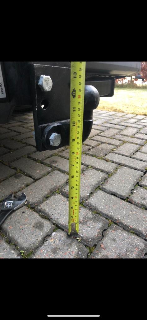

I had same issue with the same rack. Add a spacer to move the ball away from the towbar.
This is what mine looks like. Also lowered it so the doors can be opened with the carrier arm folded down. It’s a bit low to the ground and occasionally scapes now but it good to be able get the doors open with it on.
