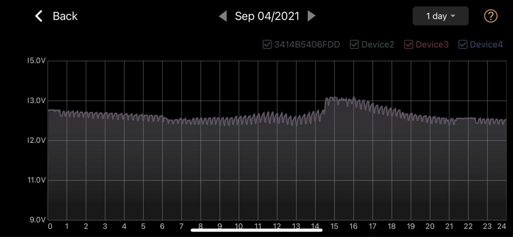

Depending on the state of charge, I can see well over 13v if the van is off hookup and the sun is out.
The example below is with the van off hookup all day, the fridge was running all day. At 2:30pm, the sun finally came out from behind the clouds. At 6:30pm I started the engine which ran for about 90mins. You’ll see there is no change to the voltage curve when the engine is running. All examples are like this.
