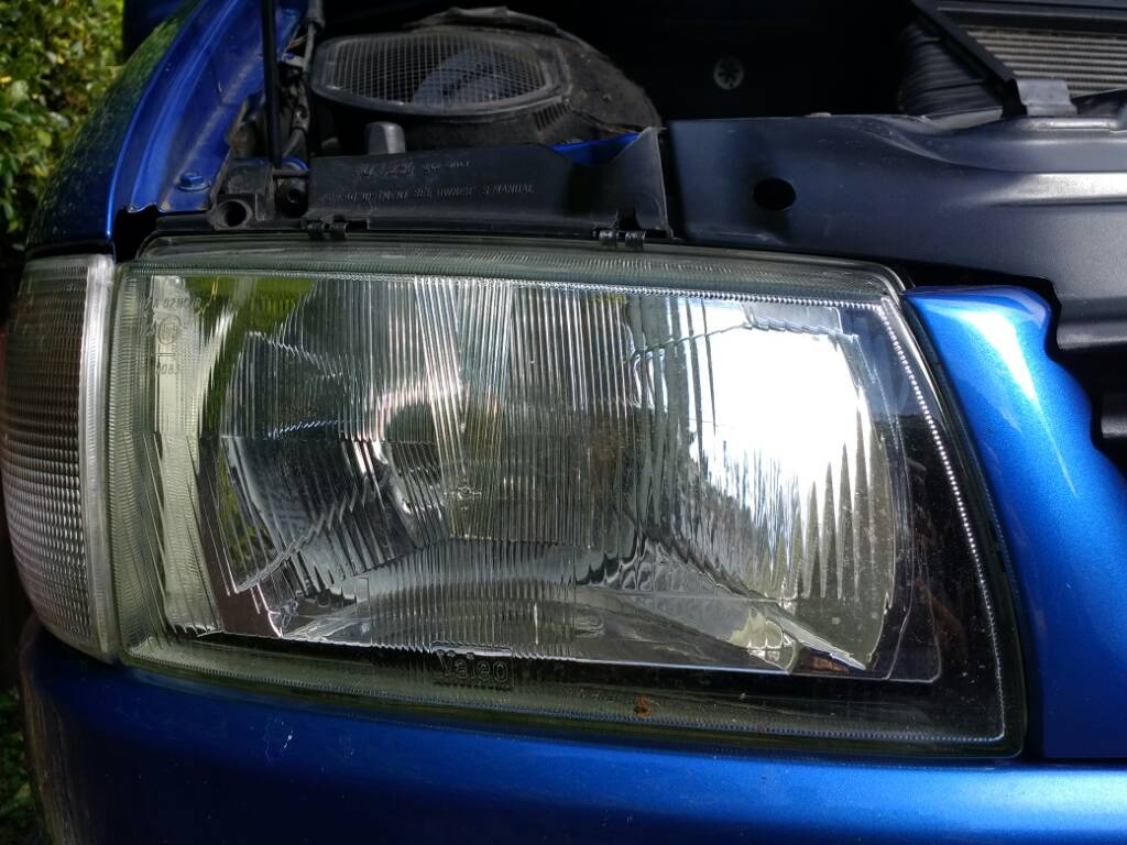

I've just bought some rhd headlights for my long nose Westie. However, they look identical to my existing ones which I assumed were LHD.
this is my current o/s one
this is my n/s one.
Looking on the net, someone suggested that the direction of the 'half bow tie' on the lens gave the game away but I'm still not sure. Could anyone with a long nose please have a look at theirs for me?
Many thanks
Simon

Mine are RH drive, assume your near side is drivers side, then the pattern is correct, replaced mine last year when imported from Germany.
Your lense pattern looks like our headlights. They were changed for RHD units when Deepcar imported ours and modified it for life on UK roads way, way back in 2003.
Thanks guys, looks like I just bought some rhd headlights that I didn't need!
