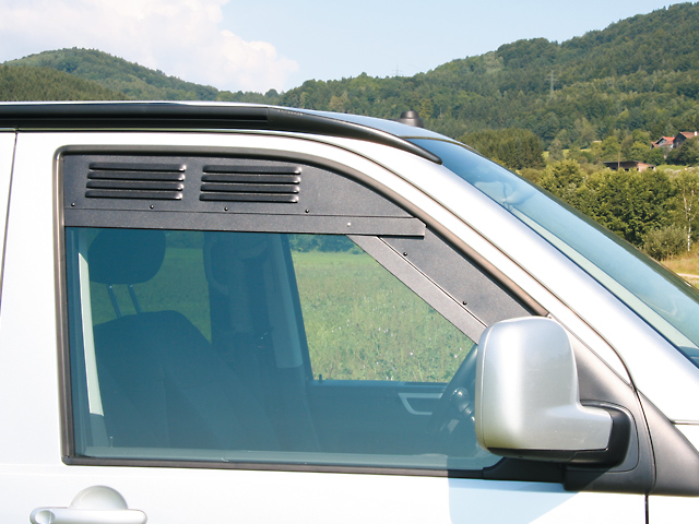

These Brandrup vents fit in the front windows but imho look like something my father knocked up in his shed--> https://www.brandrup.de/en/brandrup...accessories/vw-vehicle-exterior/vw-airscreen/

I use the Front Cab vents as sold in the club shop , the Dubreflecta for overnight stops and made my own version of the Brandrup Airscreen.
The Front Cab window vents we use on site as you can lockup securely. Well as securely as you can with a canvas roof. Works for us.

I've got Dubflecta and can report they do what they're meant to do. I will say however, their contour fails to follow the contour of the glass when its open. It's a close match but it no way perfect. I can't say I've noticed any increase in wind noise.

I have the Dubflectors too and I find the ventilation from the front windows enough when it's raining - but I only camp in UK.
any views on Dubflecta vs VW OEM wind deflectors please?
I have Dubflectors and am happy with them. I think you'll find most people have one or the other and are happy with them so it's probably just down to which look you prefer.
