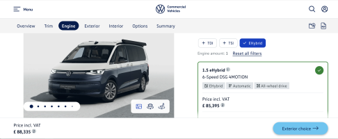

perhaps not new news, but I'd not seen it until I got an email from VW just now.
c. £7K premium for the Hybrid over the TDI & Ocean starting at £85,395 / Coast at £78,495
Only a 6sp DSG gearbox? Thats a downgrade.
I think @WelshGas posted the other day that 1st gear is now electric drive, so 6x 'mechanical' gears ?
Yep, ordered it and got £9K off.
Interesting about the 6 speed DSG

9k off, Interesting.
I’ve only recently noticed that they now do a 4motion 245hp Beach! Shame the 200hp 4m was never available on the T6.1 Beach.
