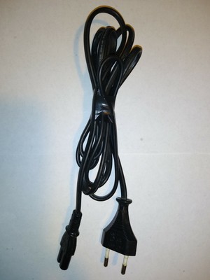

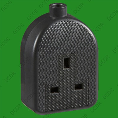

I have one of these replaced one end with a UK socket and charges my laptop fine when not on hook up
