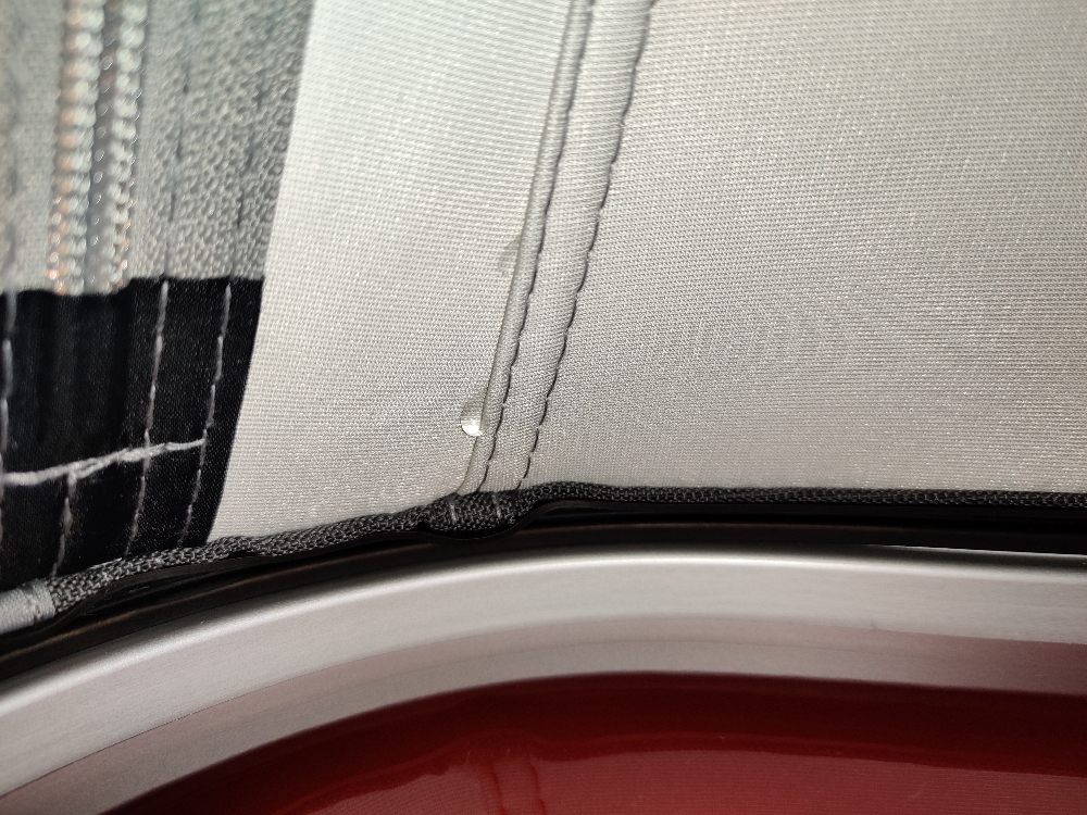

Not wanting to distract from the leaky 05S news (that glimmer of hope didn't last long!) but a wet WFH day gave me the opportunity to expose our 04S another few hours of rain. This is only the second time they've been up in wet weather, neither time particularly windy and no wetting out of the exterior.
In the interest of balanced reporting, they held up ok again. There were a couple of small beads of water starting to come through on one vertical seam this time, but it never developed into a stream. When things dried up outside, on the next check the drops had disappeared inside without intervention.
I'm still planning for them to leak badly if really pushed with prolonged wetting of the outside, but hopeful that Aquatex will then come to the rescue.

My 04S leaks along the horizontal strengthening rib on the front section when tested with a shower hose. No leaks anywhere else, so an improvement on my 03S (which leaked from main front window seams).
