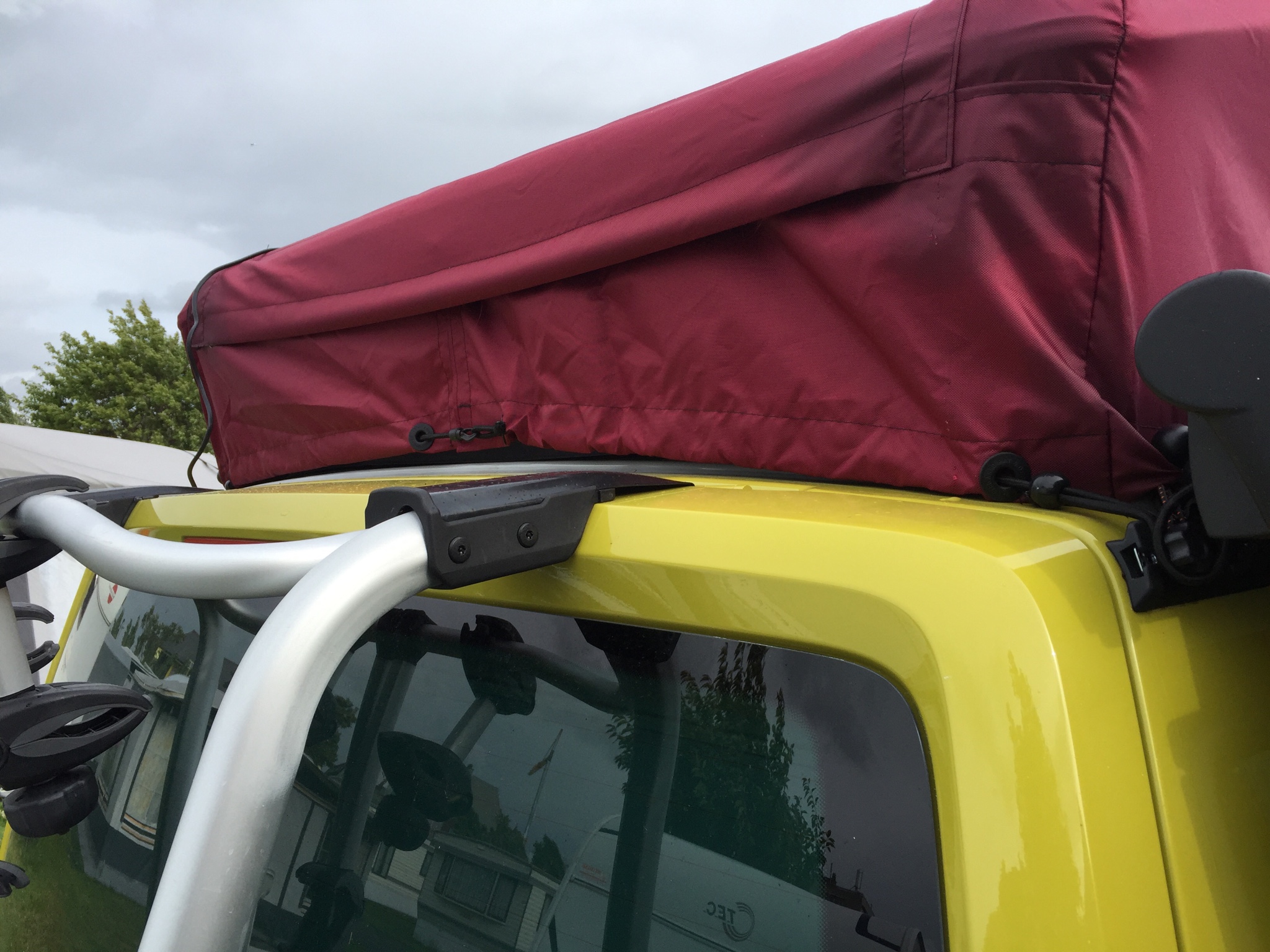

My roofless topper has a seam that fills with water. It is the seam on the rear flap - it appears that water drains from the roof, and floods down the rear flap, and some of this water drains into the seam. See photo below.
You can see the bulge in the water filled seam.
Is this a design flaw in the topper, or am I fitting the topper incorrectly?

I have camped in the rain three times, and each time this has happened. I was concerned that I was at fault in the way I put the topper on the roof. This time I was careful and checked to see if the seam had filled before I removed the topper from the roof.

We have the same all the time it rains. The bottom seam of the cover flap turns into a water sausage, sometimes also the seams of the back flaps.
We think it is a design flaw. Those seams should be sealed or glued, not stitched.
Yes - I came to the same conclusion, the seams should be taped like you find on the better quality water proofs.

I've had same problem with my normal topper after heavy rain. If you glued the seam then you wouldn't have the stretch when fitting. When I take the topper off after rain I always wipe down with a wash mitten to soak all the water, works a treat.

Sorry about the issue - Give us a call when you're back off of you're trip and we'll get it corrected or swapped :thumb

We also had the same problem with our roofless topper. Seams filled with water had to let it hang for ages to let it drain.

I have had a similar problem with my roofless topper, the two side seams have filled with water but never the back one.
I've spoke with Nick at Everything@VWCalifornia who has been really helpful and offered to replace the topper.
A few days ago I went to see Nick and return my old topper and buy a few more items, my replacement topper is due to arrive on Monday.
Even though the two side seams have held some water everything else has stayed completely dry and has worked really well. After meeting Nick and receiving such good friendly service and advise, it has only increased my respect for him and his products.
Thanks, I've made some drainage holes in the bottom of the rear flap, and will do the same with the side seams if necessary. This should mitigate the problem without affecting the functionality. If necessary I'll contact you in September when we return to the uk for two weeks.

After heavy rain on the Champagne Tour, I discovered water was trapped under the seems. Quite a lot actually. Had anyone heard of a solution of the problem? I wrote to Comfortz (Chris?), but no answer was returned yet.
I think it would be possible to glue the seems where the water is entering.

Hi Kmann, Nick Here from Comfortz apologies not spotted your email, if you can forward it to comfortzleisure@aol.com we'll get another Topper out to you, would you mind emailing me some close ups of the stitching in this area so I can take a look at what the issue maybe :thumb
