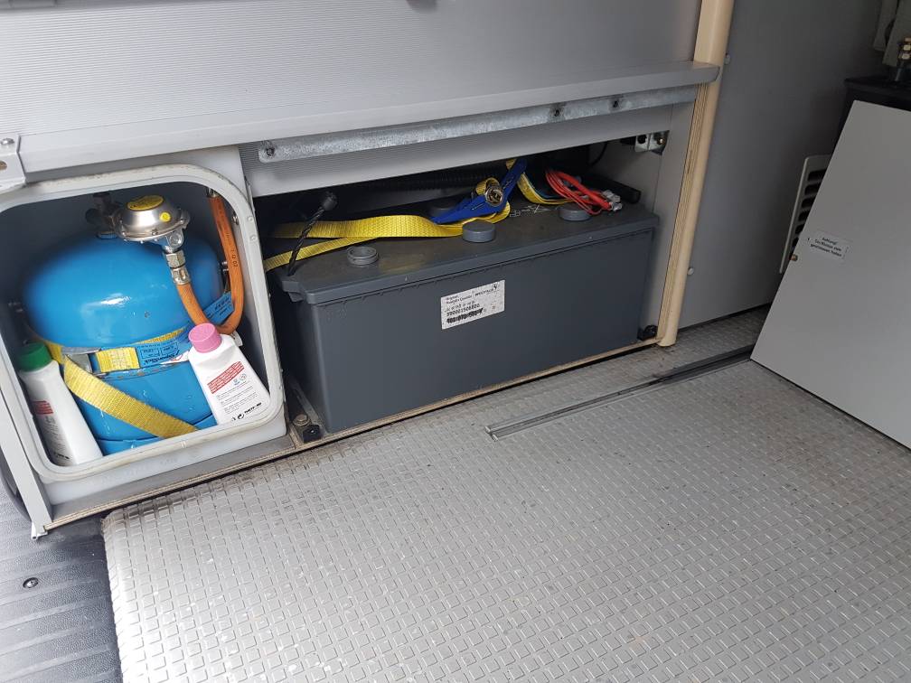

So I am planning to stick with the original spec of 140ah battery or can I got for a larger ah rating without any problems??

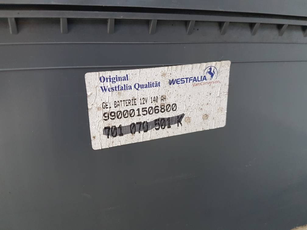

Was the T4 supplied from new with gel batteries?

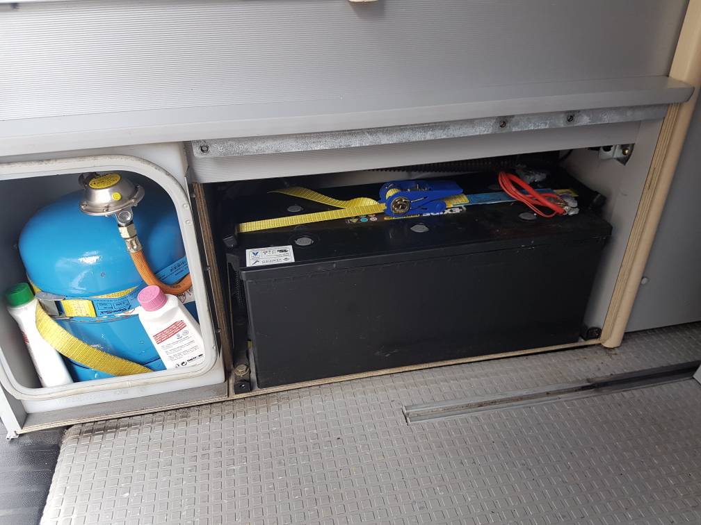

The mains charger in the Cail, does anyone know what type of charger it is and does it do multi stage charging, bulk, absorption, float & pulse?
I'm struggling to find out what type of battery was originally fitted to the Cali, gel or what type.
Regards Padraic.
Does this help?
http://www.oemepc.com/vw/part_singl...070/subcategory/420000/part_id/3707145/lang/e
There are the DIP switches on the rear of the control panel to select battery type and number.

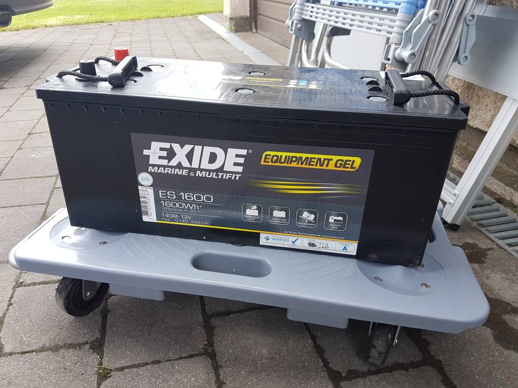

I've had a quick look at the prices so that I know what to expect when buying. I've decided it will be an Exide ES 1600 140Ah Gel Battery I'll get, as its the correct one for the T4 Cali & its recommended as a Class A on the NCC verified leisure battery scheme.

Cheers, yea it’s good to know they are a good company to deal with and that the EXide ES1600 is the correct battery.
It’s a shame that their shipping cost to Ireland is so expensive!!!
I’m gonna be in the uk for the Goodwood festival of speed in July, but Tanya are not located close by and won’t deliver to a collection point, so I may have to pay for the shipping.

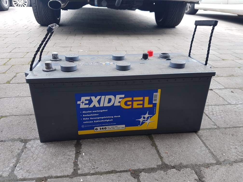

Yeah that's naff, I paid £37 postage, it was delivered on a pallet. 80 is steep. My battery started not holding charge for very long last year and now had got to the point of 10v and the display panel flashing. I didn't mind as it's lasted since 2003 so not bad at all.
Sent from my SM-G930F using Tapatalk
Does the packaging seem excessive??
