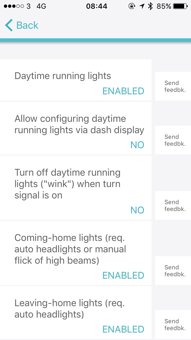

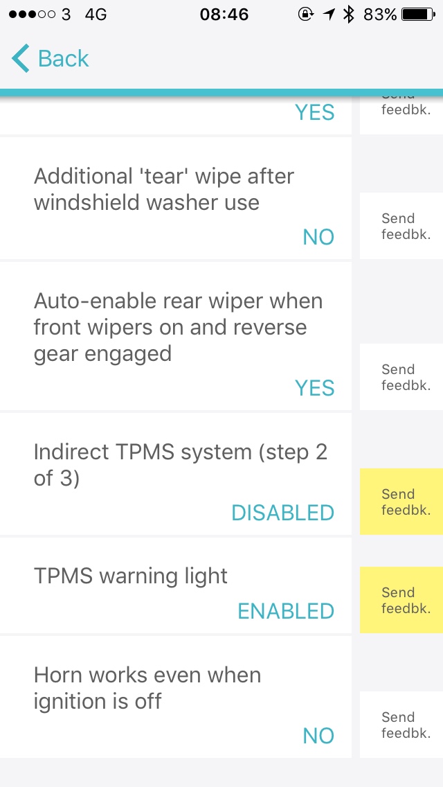

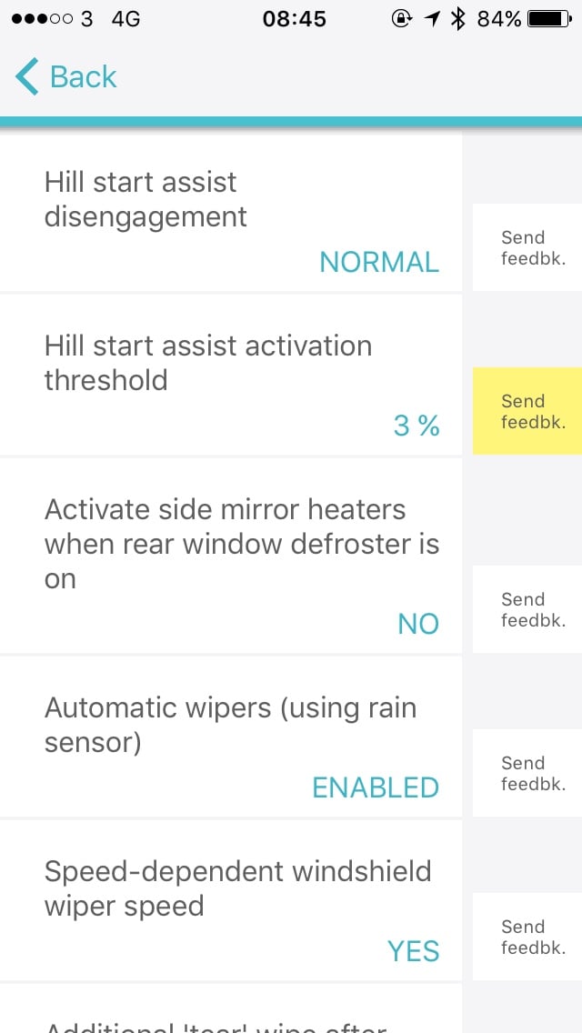

Not unless it changed between 2014-2015. Enabled it on mine, as well as Instrument wipe on start-up, Tear wipe after windscreen wash/wipe and Come Home Headlights.

Can't help much as I have only seen Carissa and as I'm beta testing and not paying I'm quite happy. All I've done is added an audible beep on locking/unlocking and given the option of the large MPH in the MFD.

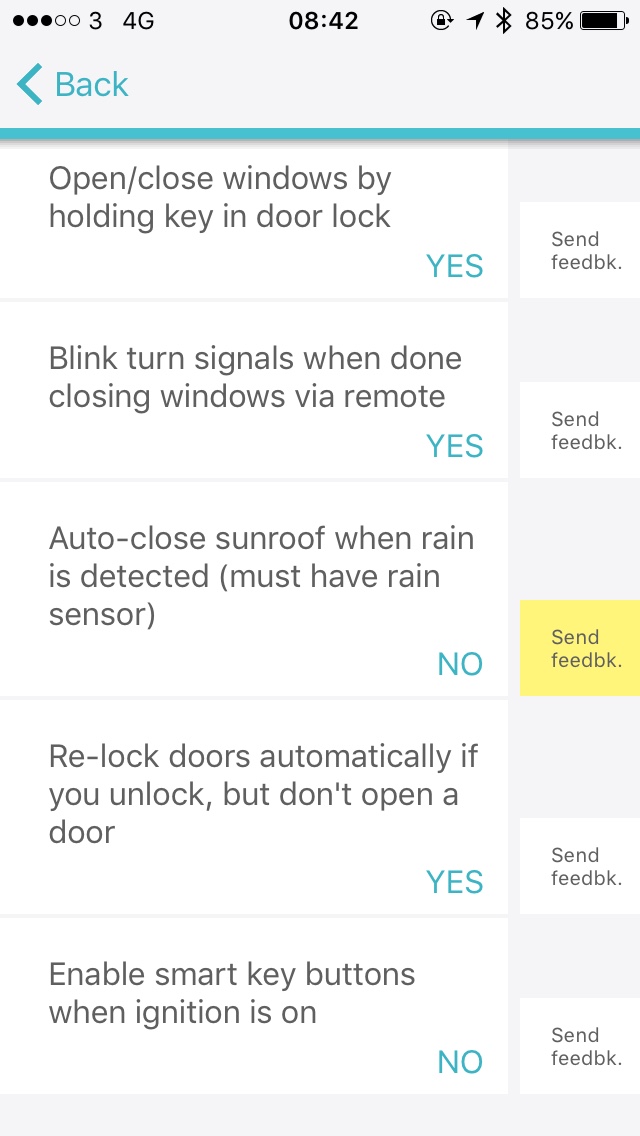

Just bought a Carista dongle and on the first free month of the subscription, not sure whether I'll pay up for it permanently yet as I have access to Bosch KTS diagnostic kit. The Bosch does have a couple of different configuration tweaks over Carista such as sidelights on with the ignition but no option to enable cruise control or MFD. Need to see what it can do on my BMW and Honda.

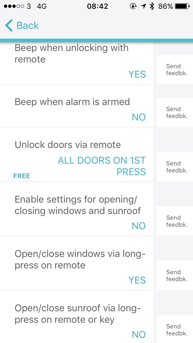

As an aside I plugged the Carista into my work T5 van (2015 Startline spec) as well as my Cali. Neither have auto headlights but I could only get 'coming home lights' to work on the Cali and the audible noise on lock/unlock is a beep/beep-beep on Cali while the van used the much louder horn! Not what I want when I finish work in the early hours.
I have April 2015 t5 180 4motion dsg. Was told by my dealer that there was no option to auto lock the doors . Is that correct ?

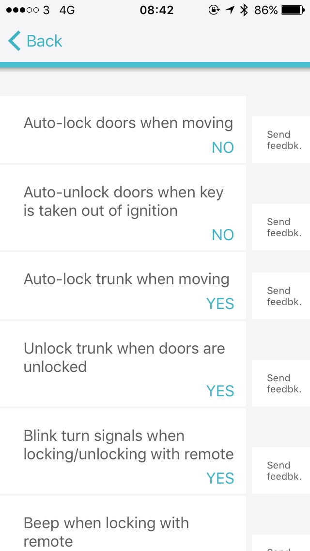

To confirm, I successfully turned on auto locking over a certain speed on my July 2015 California with Carista and on my May 2015 van with Bosch KTS.
I've been playing with my Carista and have done the usual changes of door locking when moving and unlocking on key removal, and unlocking the driver's door only etc etc. Favourite feature is still a childish one of having the needles on the speedometer flick all the way round on key-in though!
