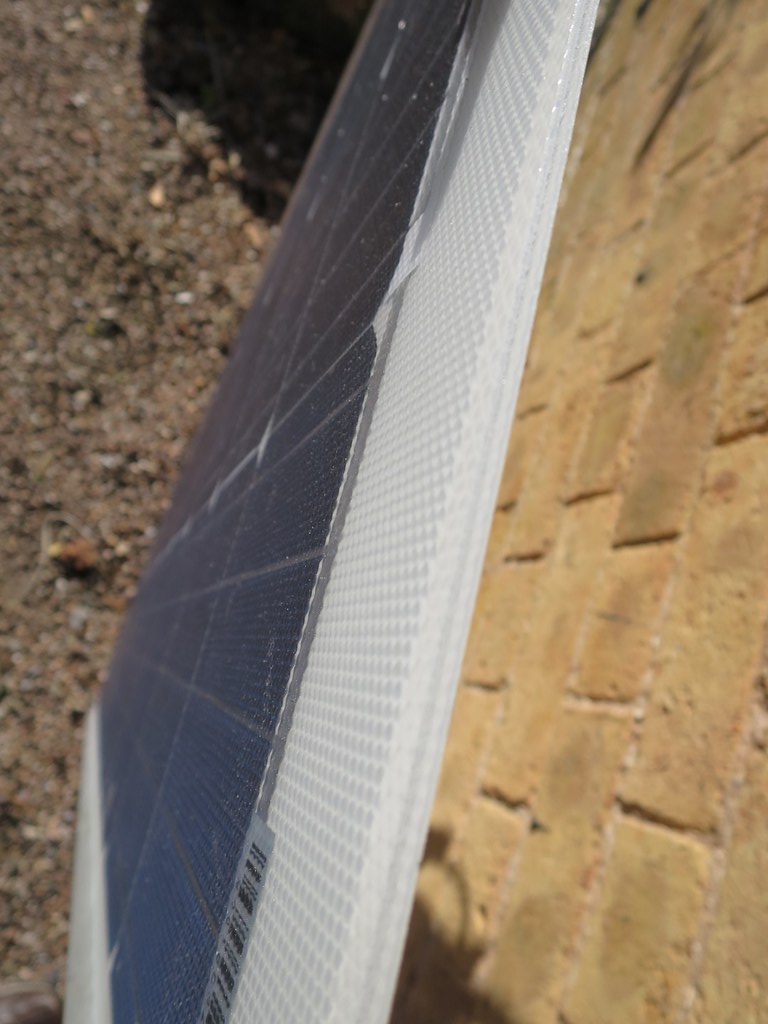

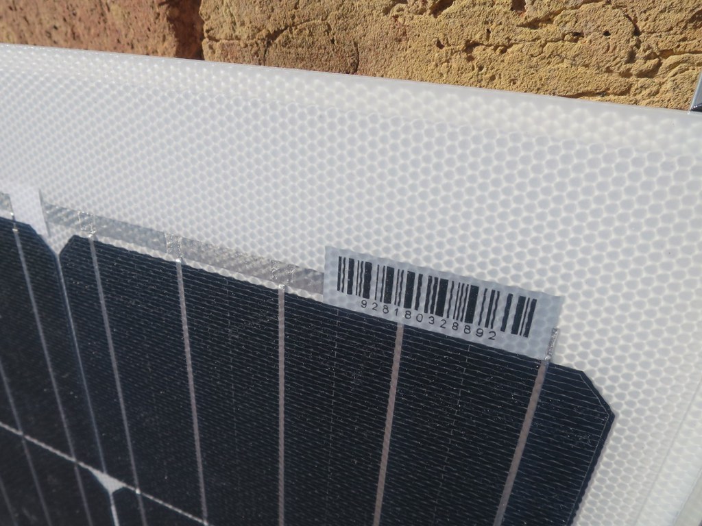

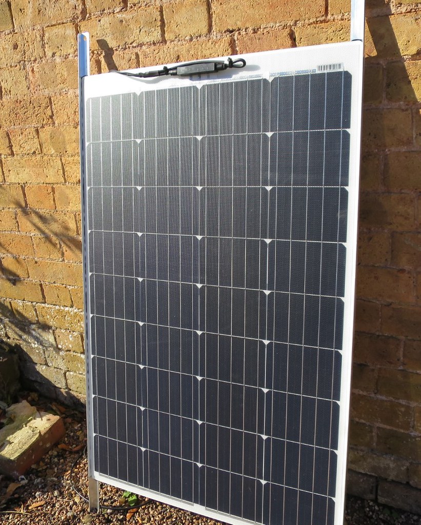

A few pictures below of the new panel type - they are a superb quality panel and we are confident enough in them to be bulk ordering a big batch in the New Year and having new packaging made to suit their wider and shorter form.
Above, you can see how much thicker they are than regular thin plastic panels.
