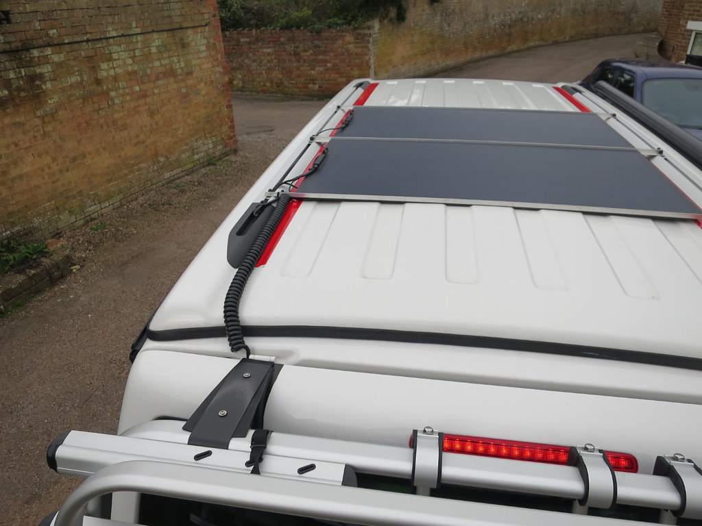

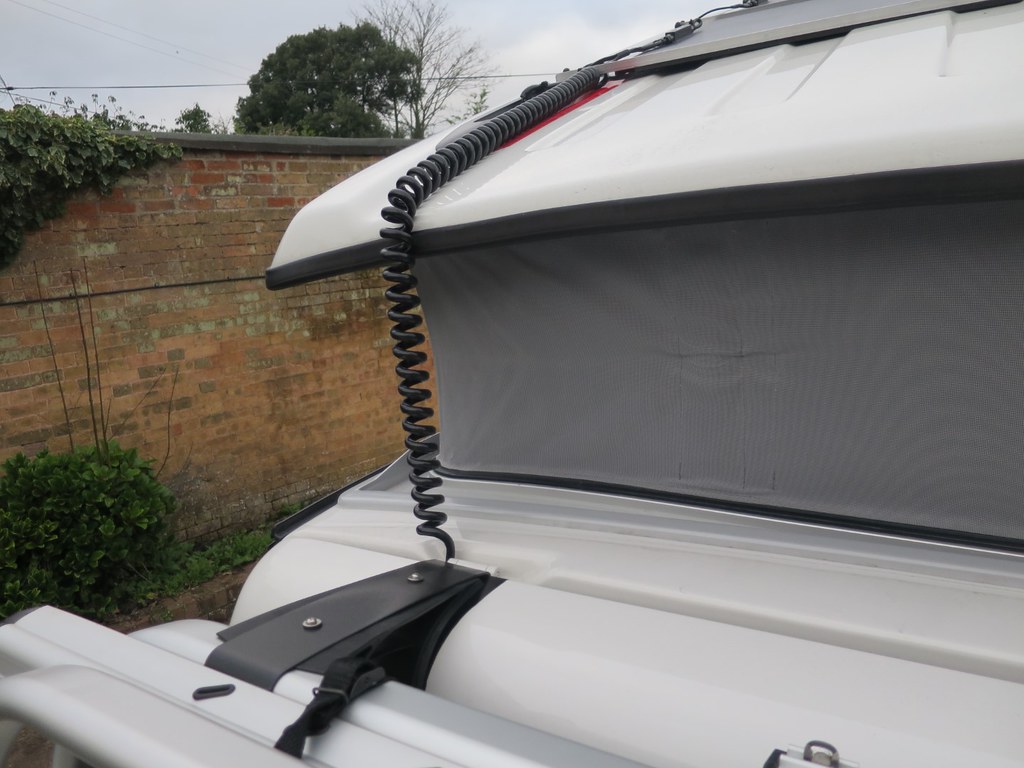

Ok, curly cord has been tested for fit and I've ordered a batch of cables in, ready to make the conversion kits.
The cost for an upgrade to existing customers is a discounted £22 + postage (£3.45). It will be slightly more on new orders.
If you can contact me via my email (below - in this post footer) rather than a PM on here, then we can arrange payment and delivery if you want one.
