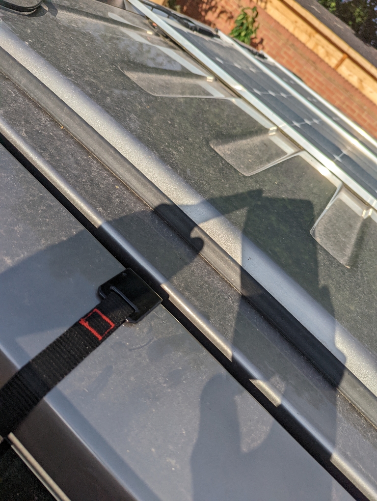

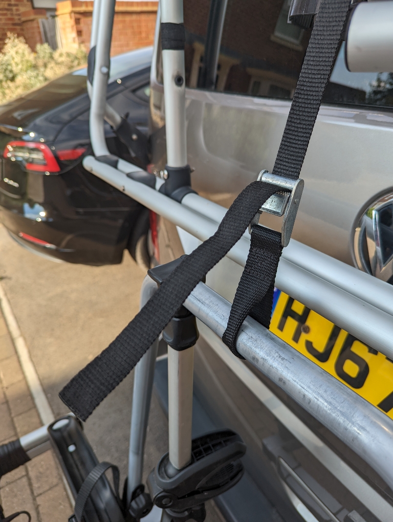

Check - is it 30 kg per bike for a total of 60 kg? Else, belt and braces could be the solution. Use the rack but use an additional support strap .
See pic. Strap from the rack to the door top.

That looks like a solution. FWIW I miscalculated on the bike weight, it's 35kg, so if I remove the battery we are getting very close to the notional 30kg limit. My wife rides a three-wheeler that folds and is carried inside the Cali, so I'm only planning on carrying the one ebike on the back.
