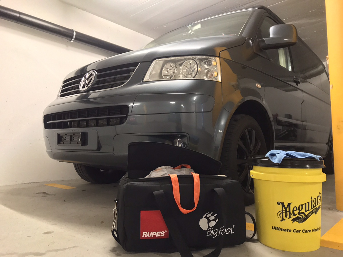

Rupes here too Your vans look amazing! Congratulation!

No expert here at all re Rupes, however I was told and that is also my impression that they are quite simple to handle and use. As long as you go for a "random orbital" one (https://www.rupes.com/bigfoot-system/bigfoot-system-tools/bigfoot-system-random-orbital-tools/). Feel free to correct my impression re "rotary, gear driven and random orbital".
I found some useful YT vlogs. My five points I try to remember (correct me please dear experts):
1. Better wash it properly than polish it (or wash it again and use clay)
2. Let the machine do the work (do not force or push it around)
3. Only use a little polish cream on the right polish pad (buy two of each and wash them)
4. Polish with a system (from left to right, top to bottom) and protect the rubber car parts
5. Sometimes a good hand polish looks better than a quick machine one
Hope that helps and any feedback is useful and keeps me learning
