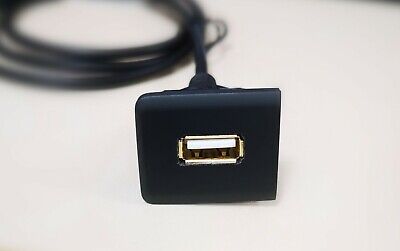

You can also easily fit these tidy sockets in the existing dash blanks for units that have USB ports on the rear:

I fitted the USB in one of the passenger side switch blanks with araldite, quite a neat solution but I may move it over to drivers side as if a memory stick is inserted it gets knocked when rotating seats.
