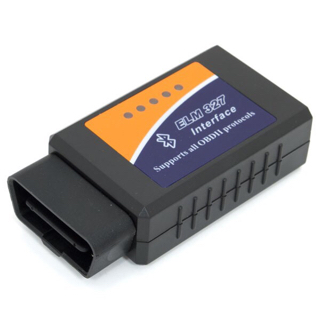

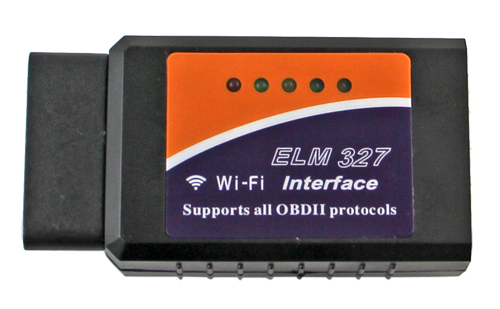

Are you using the WiFi or Bluetooth version Matt? (pic is BT but read comments that WiFi plays nicer with Apple devices?)
I'm using a wifi one yes. I believe the BT one is for android and wifi for iPhone?
Updated the image.
