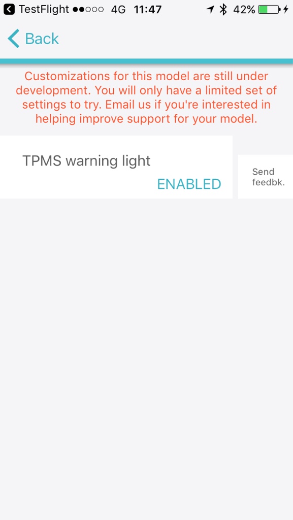

Received beta version and have just ran a test seeing its raining outside at Lower Lode.
No faults but not appearing to read everything.
In customisation there was the ability to turn off one or two items but nothing of any great significance or interest in changing other than being able to change some settings from miles to km.
In service can do a reset.
Have sent all data to Carista for their info.

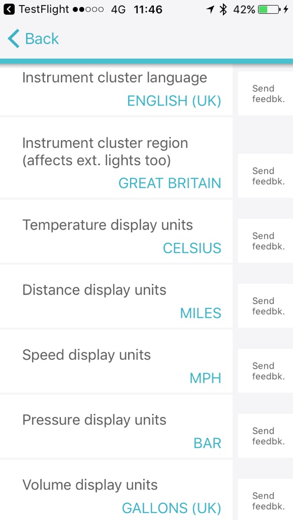

I'd also like to be able to change the KMH large display to MPH and back. Most of the options I'd set once and probably never change.

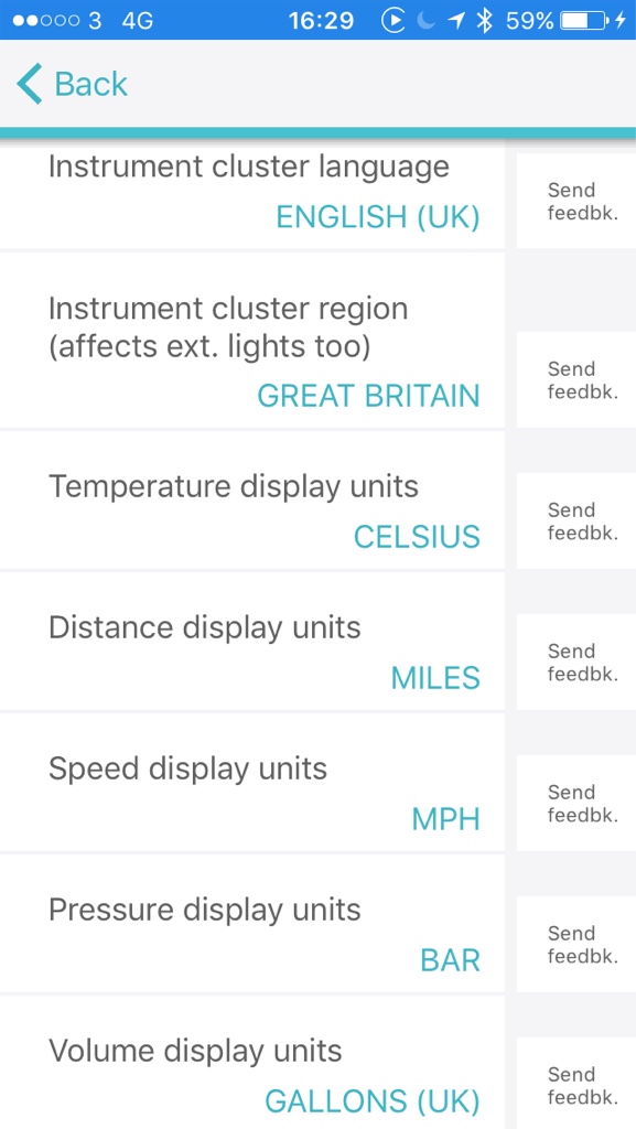

Carista can do that now for the T6, you just need to change the region setting from UK to australia! It then puts the temperature where the km/h display is, and then gives you a big MPH display with the mpg etc. It also enables a box in the settings page to go back to how it was, without having to use carista again, so when you go abroad you get the km/h display back again on all pages.
Edit: Instructions are here: http://www.vwt4forum.co.uk/showthread.php?p=2303455
It is much easier with carista, as it is just a simple drop down list change. It is confirmed working on my T6 ocean.

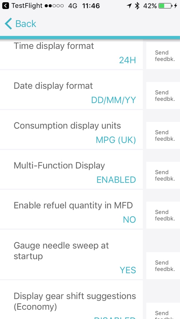

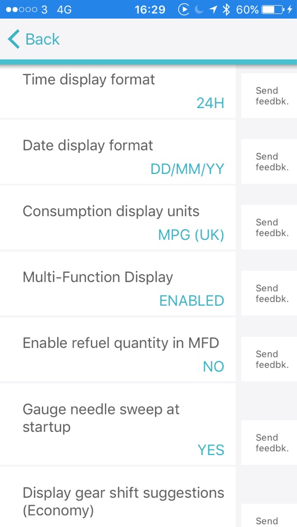

Screenshots from customisation menu.
Carista requested another debug report so done and sent.
Fingers crossed for more options
Mike
Super thanks for that, couldn't get it work on the hire vehicle but never thought about changing the region! :thumb
Followed the link from the T4 forum and he got it from here:
https://vwcaliforniaclub.com/thread...display-on-vw-t5-california-dash-insert.1536/ It's gone full circle
Given the change of position of the large Mph display as s shown on the modified version, would this affect other readouts, such as ACC alerts, fuel consumption, etc., Or does it just disappear?
It acts just the same as the mpg and the other trip computer values, it is just a bigger font for the speed.

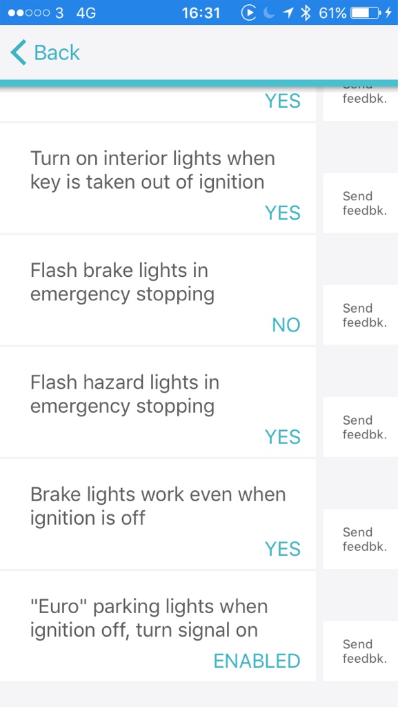

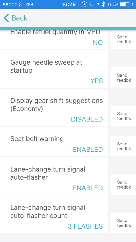

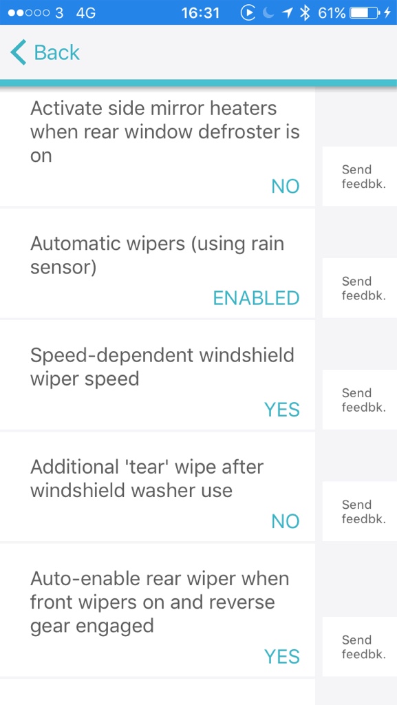

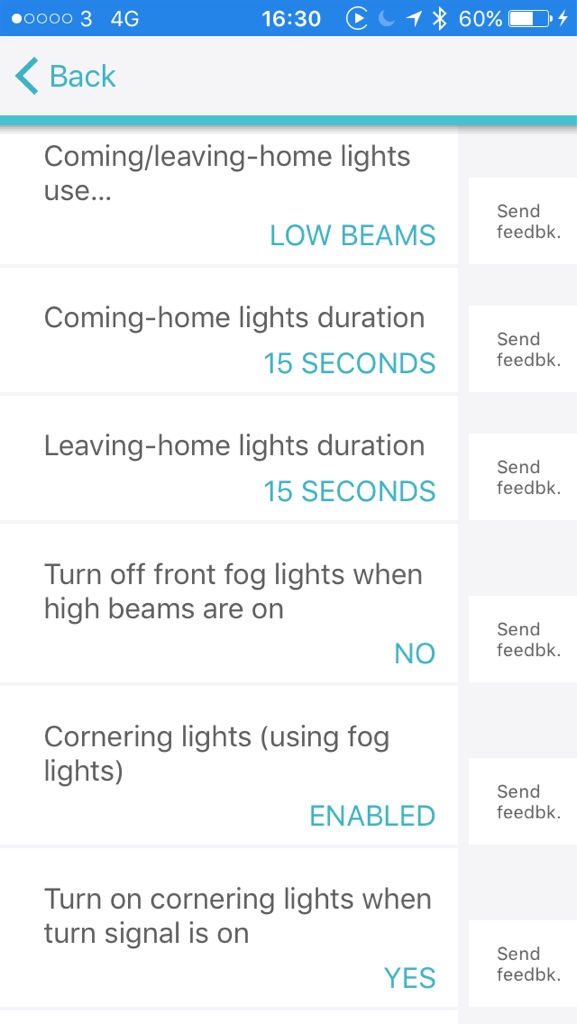

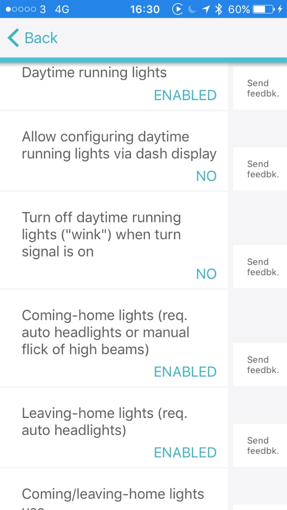

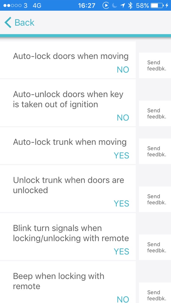

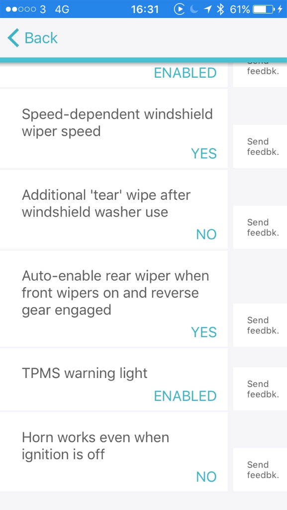

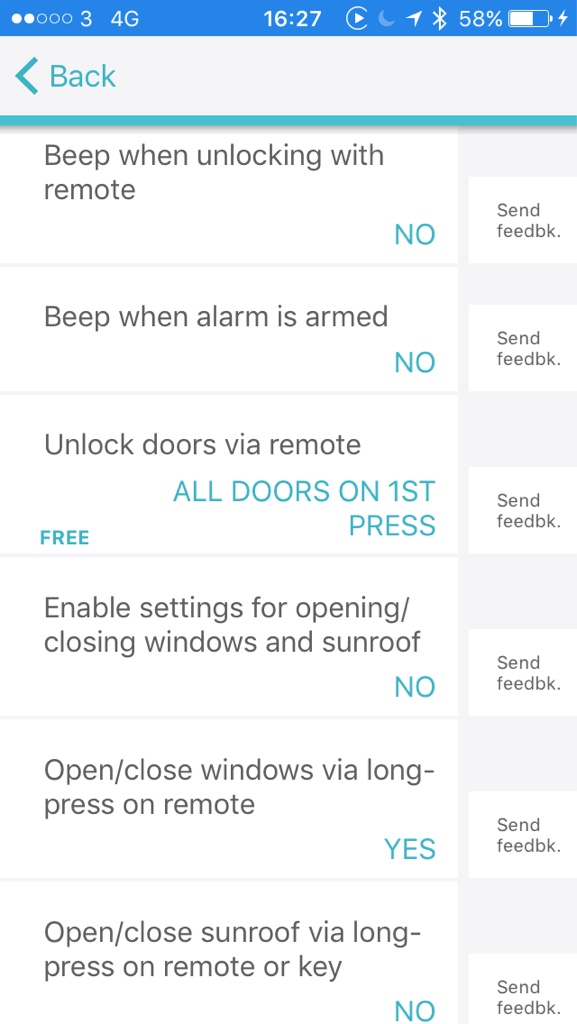

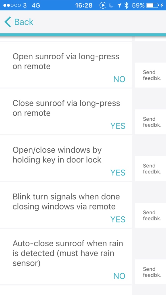

Another Beta release so done another debug and sent results to Carista.
Seem to have some more customisations as per screenshots:-
Mike
Thank you for posting the screenshots Mike. I like the idea of all doors unlocking on first press.
Mike.
That all now looks the same as the options available for the T5. All good stuff.
Mike.
Thanks that's good to know.
