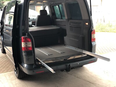

Rear Sliding Tray
I'm gonna DIY it one day soon, just looking at collecting the bits
and it seems to be a minefield - or maybe not-
Weight limits on the sliding hinges that i have found seem to be >130kg or >250kg,
i'm thinking of going for the 250kg so that 2 people could also sit on the shelf whilst
slid out watching the sunset.
One post above used 80kg ones.
So far i have seen 2 choices of hinges and a set of fixing brackets, i have also
seen an easier solution where they are all fixed together and all that is needed is the
drawer part.
Here's where i'm at -
Also there are locking ones and non locking ones, would the locking ones be
needed?
Sure, the drawer would stay in place without the locks?
I'm probably over thinking it all but i'm up for a bit of info,
abuse also will be happily received :D
Here's the link for the half made one -

I'd suggest locking ones would be needed. If you are parked uphill, when you open the boot the drawer will be at the perfect height for your knee caps. Likewise, if you park downhill, ever time you pull the drawer out, it will self close.
I've locking ones on mine have three lock positions...full in, max extended and at about half way. Not sure if they are all like that, but mine are.

I used 85kg ones from Amazon, they have 3 locking positions, and they're perfect for what we need as we don't use the tray to carry anything that heavy, such as the fridge.

Hi, you must use locking rails else the tray will move as you accelerate & brake, or as you use it on anything other than level. >100kg is definitely a good plan

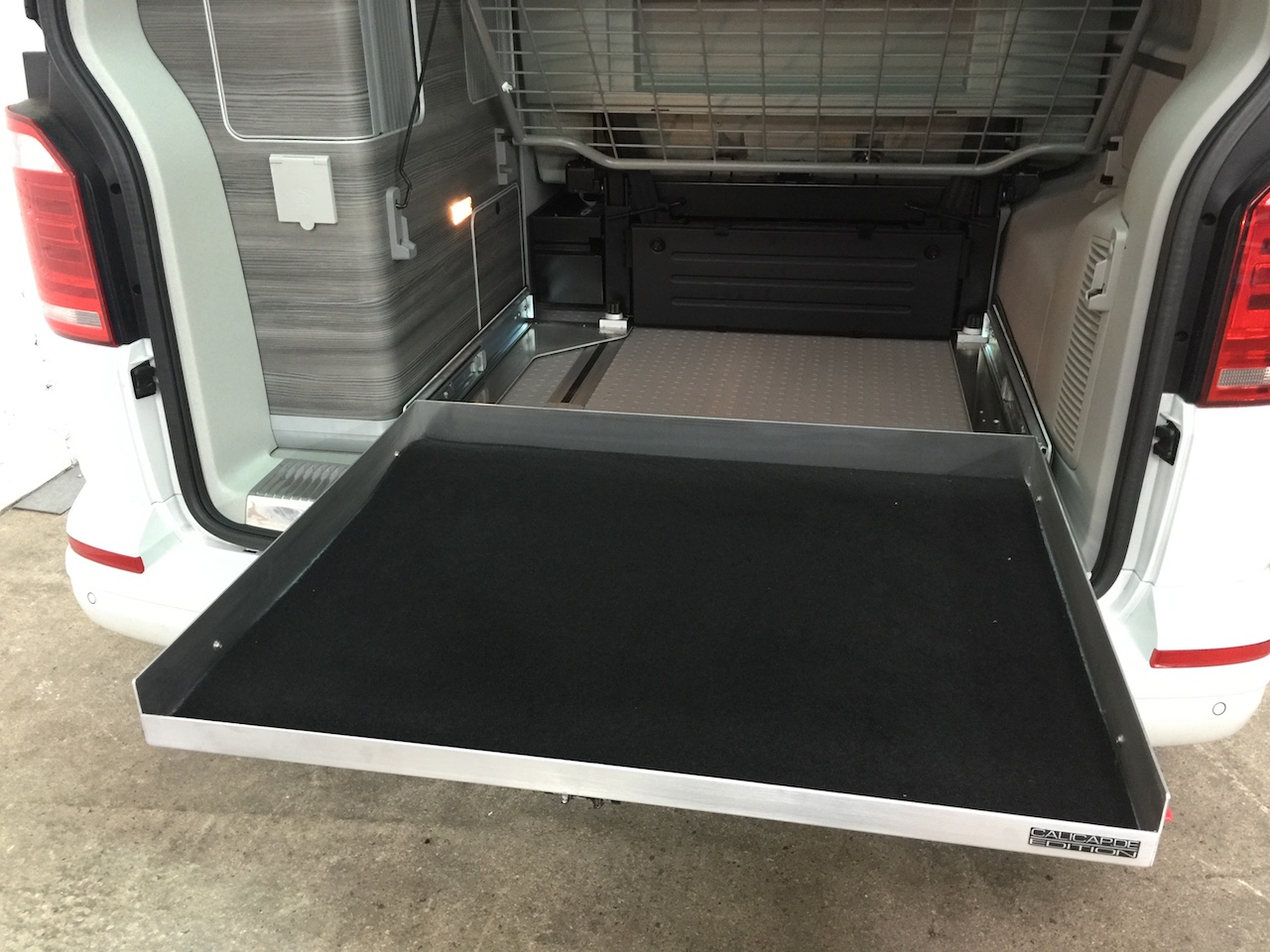

Calicap do one for the T6.1

The shop version fits the T6.1.
That’s great not only is it full width they do a shortened version for the 6.1. Thanks.
