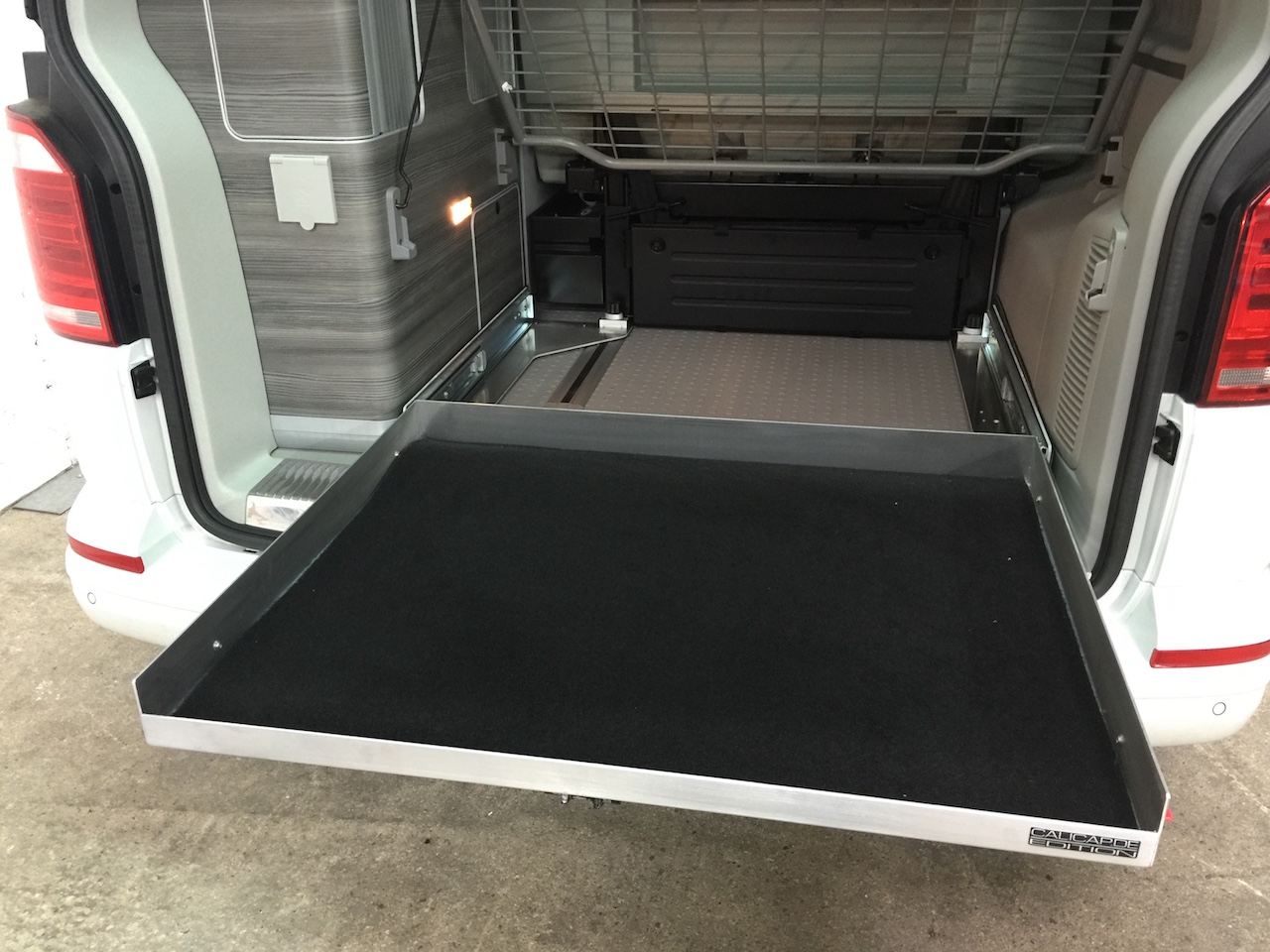

Just about to try making my own tray - I think I want it about 800mm deep to allow it to slide out fully with a tilting bike rack in place. The one in the shop is 600mm.
Ordered 50mm x 50mm x 3mm angle to mount the rails onto, and to make the tray frame. Also ordered some 3mm bar.
Is 3mm ok for the tray frame? I've seen builds on here using 1.5mm or 2mm.
What would be a good thickness for an aluminium sheet base? 1.5mm, 2mm, 3mm?
Cheers
Cheers
I used 3mm and it’s solid, but being aluminium quite light. Holds 80kg no problem. I used 13mm plywood for the base. Again, it’s solid showing no flex when fully loaded. When sizing your tray you may wish to consider sizing it to accept Euro crates which come in a range of standard sizes. Mine holds 2 of 600x400x175h (or 4 in two layers if the bed is set in its upper position) and 2 of 300x400x290h. As mentioned in a post above if you go for the size you’re suggesting, it will slide almost all the way out with a tilting bike rack on the back.
All in all the most useful thing we have done to or bought for our van.
Thanks Jim, yes definitely sizing for eurocrates, and am looking at the ones you ordered. I've ordered these 160Kg sliders, which are 762mm. I'm not sure whether these or the 812mm would be better, I can always swap them out if necessary.
https://www.amazon.co.uk/gp/product/B086JQ9DL2/?tag=unique09f-21
I'll mock up the tray frame in wood batten 1st to confirm sizing and positioning against the bench seat and the bike rack. My bike rack is a Thule XT Velospace 3+1, but rough measurements show it should slide out fully.
I used 800mm 80kg sliders with no problem. Same manufacturer through Amazon.
