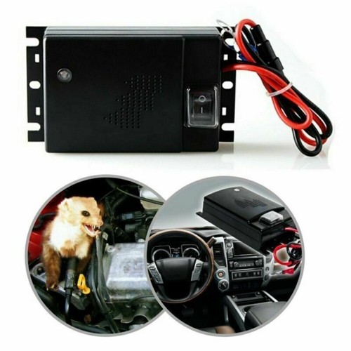

I fitted one of this type of unit after reading of electrical wiring being attacked.
No idea if it works but no problems as yet.

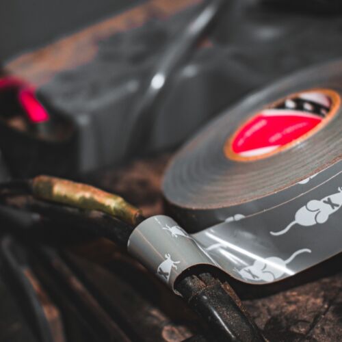

This worked great for me after 2 rodent/fox chewing attacks.
It’s a dirty job. You wrap around everything you can see. No attacked for a couple of years now.

I bought one of these rodent repellent devices and put it on top of the container that we store bird seed and peanuts, result, no difference whatsoever they still chewed through the plastic container that’s why I had to result to traps.
